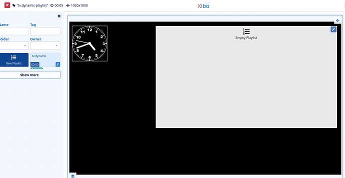

I created new DYNAMIC playlist as user, added 4 images to that playlist, created new layout and set in that layout DYNAMIC playlist module. I could not publish layout with only DYNAMIC playlist module so added clock, still can not publish this layout with DYNAMIC playlist.
As you can see top left, icon is always RED so i could not even test problem you have described.

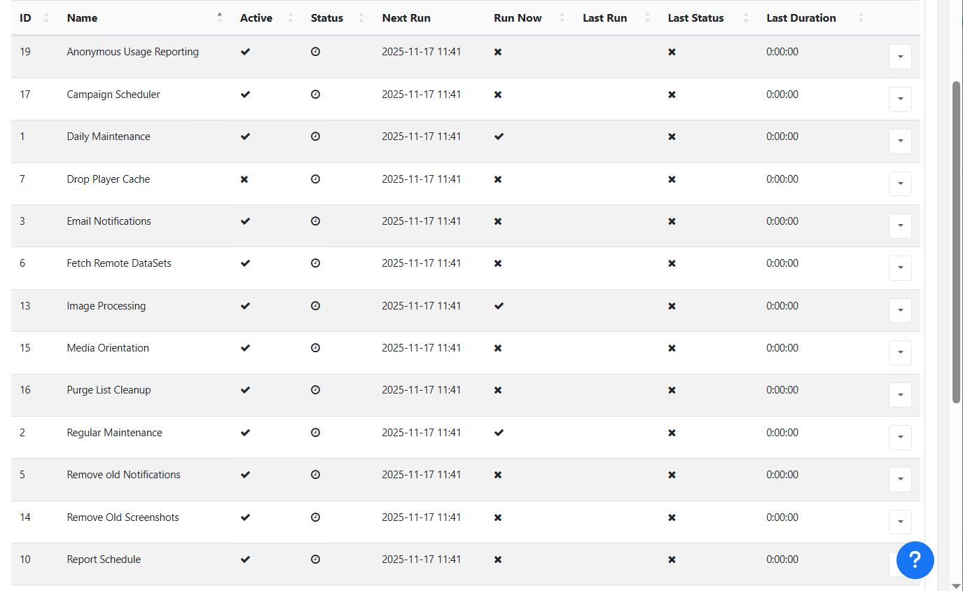

Thank you for reporting this issue. Please can you go to the Tasks page in your CMS and see if they are in fact running automatically? It’s essential that the tasks are running, as they are responsible for a lot of the functionality in your CMS remaining up to date, especially the regular maintenance task.

Your Dynamic playlist appears to be empty in your screenshot. If you view the playlist on the Playlists page in your, does it also look empty there too?

Below is a screenshot of my tasks page. I never get a “last run” or “last status” and the “Next Run” is always whatever time I look at the page. I have a scheduled task to run xtr.php, and it doesn’t appear to “fail” but I do get the following “success” in my history:
Task Scheduler successfully completed task “\Xibo Maintenance” , instance “{e42221b8-ca9b-4fa7-873c-6d2eb0569c20}” , action “C:\PHP\8.4.14-TS\php.exe” with return code 2147942655
I can manually run the php.exe etc etc xtr.php and nothing is echoed back to the console, so I’m not seeing any errors there. Not seeing any kind of failures in my event logs either.

Thanks, I was trying to add wrong playlist which is indeed empty !
I think the playlist with 4 images in list was hidden below “Show more” button and I didnt notice it was empty one I was loading :slight_smile:

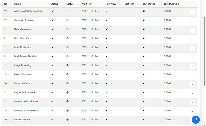

Here too.

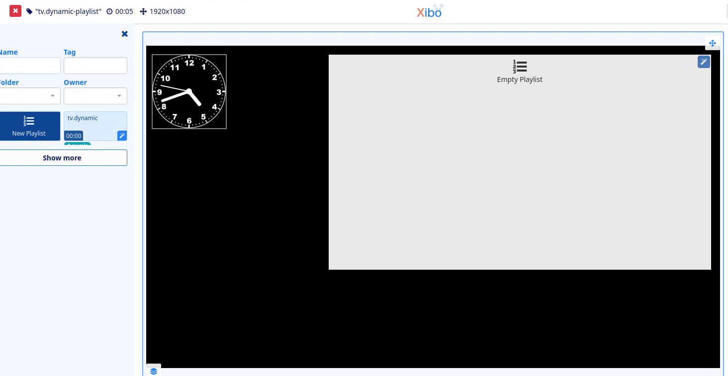

And Here:
Though I’m pretty sure that has to do with more than playlists - none of my tasks have Last Run time, Last Duration, and Last Status is X. Status is a little clock that doesn’t provide more information on a mouseover.

Looking at your screenshot of your tasks, I also noted that there are no last run dates, which would suggest that the tasks are not running.
