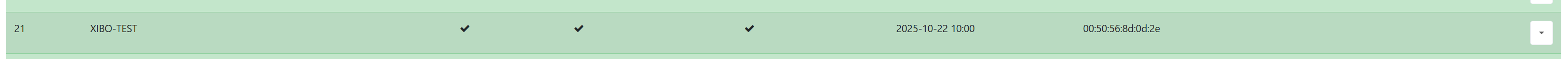

Arexibo unofficial Xibo Linux Player Xibo CMS compatibility evaluation:
+++ = veryfied
++ = confirmed
+ = only tested
Schedule:
Layout +++
Action -
Overlay — i think it default returns to Default layout, no matter on priority or display order set
Interupt +++
Campaign +++
Video/Image +++ sometimes freeze video over its total play lenghth time and then continues to run from start after some “random” delay (strange time behaviour)
Playlist +++
Data connector - never used this function
Dayparting +++
Campaigns +++
Layouts +++
Playlists +++
Media +++ (PDF management of display time/per page no respected)
Datasets +++ (i did only marquee scroller test had some problems displaying: some tickers were not built on init, sometimes does not show on first run, works after reboot)
Displays +++ (generaly all basic functions works but need to confirm ALL of display functions work separatley, for now i have xmr problems described below …)
Display Groups +++
Sync Groups – (did not work as expected, somehow xmr is not connecting properly.)
Display settings +++ (Gets applyed to player but must recheck tcp://*:9505 and Display port 9696 , does it need allow WAN?! cant get any scan on these ports. 2 devices connect xmr(get screenchots) and two does not.)
