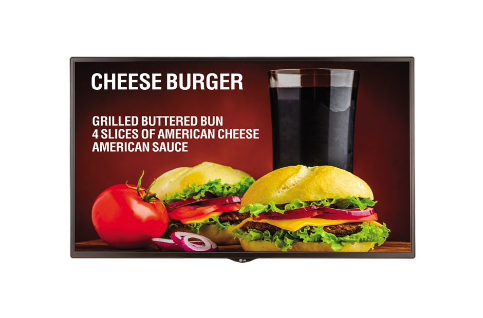

Sorry if i am hijacking this thread but i have almost the same issue.
CMS: Custom 1.8.7
Display: LG 32sm5kh-8
Firmware: 04.02.20
webOS: 3.3.0-23
Player: R15
No apparent errorcodes. It just sits there, registers as logged in and online.
I can get screenshots and everything.
But it blindly refuses to change the schedueled layout. Even a new default wont go on.
(If needed i can start my own thread on this)
=T=
Thank you for the information, I cannot seem to locate an LG Display with that model number, can you double check it is correct?
Can you also provide a screenshot of the Status page for the Display? You can access the Status page by clicking the OK or Enter button on your remote while the Xibo Player is running. Next select Status from the Action Bar at the top of the screen.
The screen is this one:
Screenshot will be up asap.
