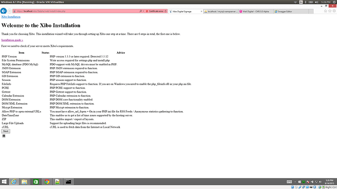

Dan,
I have the rewrite_module in WAMP for apache enabled and also have it enabled in the htacess file. I used the full URL path to the install index.php file. I still do not see the theme.

Am I missing/not understanding something? It seems to me that the problem I keep running into is that Xibo\Helper is not always defined when it should be. I ran into a couple of errors here and there that seems to point to the same thing I just didn’t want to overwhelm the site with them incase I just have something misconfigure.
You are correct - it doesn’t know where it needs to be - there are various entry points and url rewriting which means that means it is tricky to get a relative URL.
There are only so many configurations, so we will nail it eventually.
It looks to me from your URL that you have the entire folder in a web serviceable location which really isn’t a good idea. From that I am assuming you have:
htdocs which points to localhost, and everything after is folders (i.e. no VirtualHost, no alias, etc) ?

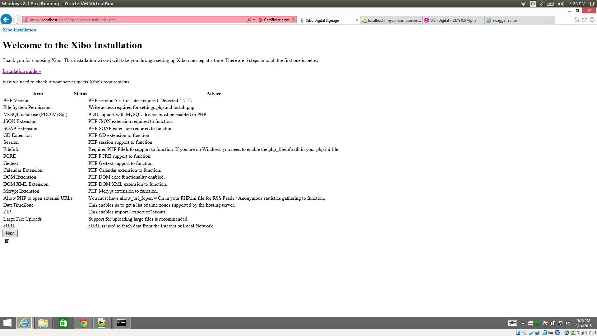

Dan,
Yes I currently do have the entire folder thrown into a web accessible location. That was to cut out using aliases for now. In a production environment, obviously we would not do such.
Would this problem also explain our problem of not seeing the theme during installation?

Its possible :smiley: i’ve only tested the “supported” installations at the moment, although I do intend to test every possibility.
I’ll give it a try when I can and see if I can work out what the issue is
I added the dev category yesterday as I felt there was a need for it now - great that more people are trying to cutting edge and experimenting more with Xibo code!
The installer theme has been fixed in the latest commit :smile:
