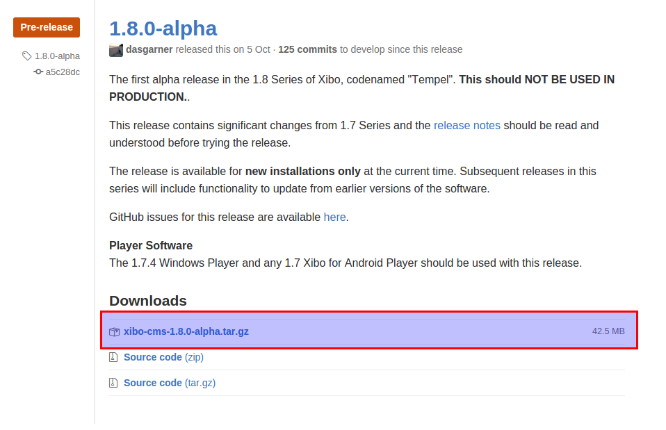

The release page in GitHub contains the source code in ZIP/Tar formats and then a release archive as a tar.gz - it is the release archive you want, highlighted below:
The release archive contains a pre-build vendor folder, which means you don’t need to get that yourself over port 22. In fact the process of installation is the same as with previous versions of the software, extract the archive according to the instructions in the release notes and then run through the web install / upgrade.
We hope to release alpha2 this week, at which point I will make sure there is a release archive in ZIP format as well - and perhaps elaborate a little on the release page as to which files should be downloaded.
