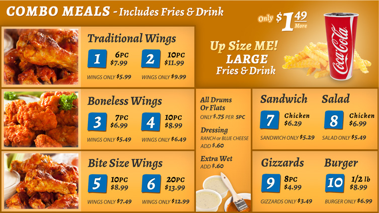

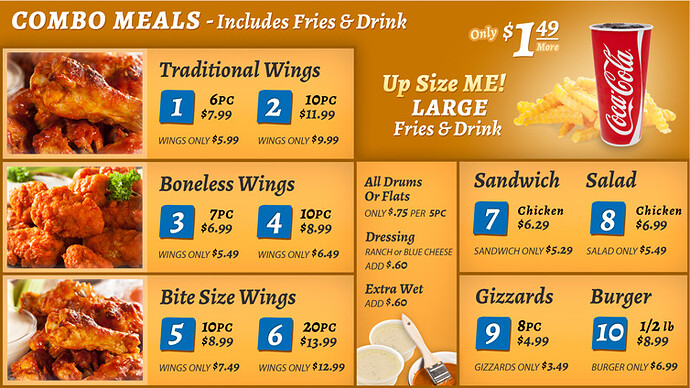

Hi Alex,
First let us say, thank you for your time. You’re right, you could have replied with a brief answer and been done. We appreciate your consideration. Our "question why" was not meant to sound sarcastic, rather inquisitive. The data sets can reference images and fonts we just wondered why can’t the embedded module do the same? As UI/UX designers, this would appear somewhat the same in our minds. Of course, in the programming world, that’s not simply the case?
To answer your question about "Why not use a dataset based ticker instead?" If we had to sum it up in one word, aesthetics. We want to create layouts that are nicely designed so the everyday end user; the store manager, a small restaurant owner, etc,. who wants premium design and only wants change the DATA of the layout - make simple data updates.
Back to data sets, I’m wondering if we are misunderstanding just what we can do with our CSS/HTML for the output on data sets? We thought we could only format "an HTML table?" It has to be an HTML table, is this correct? If so, that’s great works for so many situations, however, not so much for advance design layouts. For example, this menuboard we attached, if the embedded HTML could pull from the media library in a way the data set can pull from the library we could easily write the HTML/CSS for this menu.
Again, Xibo application is a strong application within the digital signage industry. We don’t expect it to be a design tool either, or fully polished, we are only trying to figure how to take and ASSEMBLE our designs within the Xibo system where the data can easily be updated.
Please let us know about the HTML Table and data sets. We’re sold on your application : )
What you want to do is exactly what datasets are for!
Yes you’re correct that with a dataset view, you get tabular output, but if you use a ticker instead, then you’re working with divs and you can style them however you wish.
The user then can just update the dataset and the changes appear in they layouts that use that.
The reason why is that the embedded module is designed to show some basic HTML that you might want to embed - an external widget for example.
There’s no reason why it couldn’t be developed to allow you to reference images etc in a nicer way, but that was not it’s intended use and so it doesn’t offer those features currently.
If however we were to allow that, your user would have to be editing raw HTML to make changes as the menu wouldn’t be driven from a dataset.
It would be far easier to have them edit text fields in a layout or even make a custom module than have them edit HTML.

I think you’re slightly missing my point here.
Datasets ARE that solution. They are a general purpose datastore which you can reference in your layouts, either in a tabular fashion, or otherwise.
Your conclusion that datasets == tables is very wrong. Dataset Views are exactly that, but that’s a tiny part of what you can do with them.
We’ve already got extensive work underway on the layout designer as documented on the blog post on the subject. We’re not looking to make further changes just now beyond that.
We have done commercial work with customers to produce menu boards exactly as you’ve shown, and they are all driven by datasets. That’s our view of how that kind of thing should work.
If I was able to share some examples with you I would, but unfortunately contractual obligations prohibit that. They do however look very similar to what you’ve shown, and allow the user to just update pricing and images directly in the dataset. The layouts then all update accordingly.

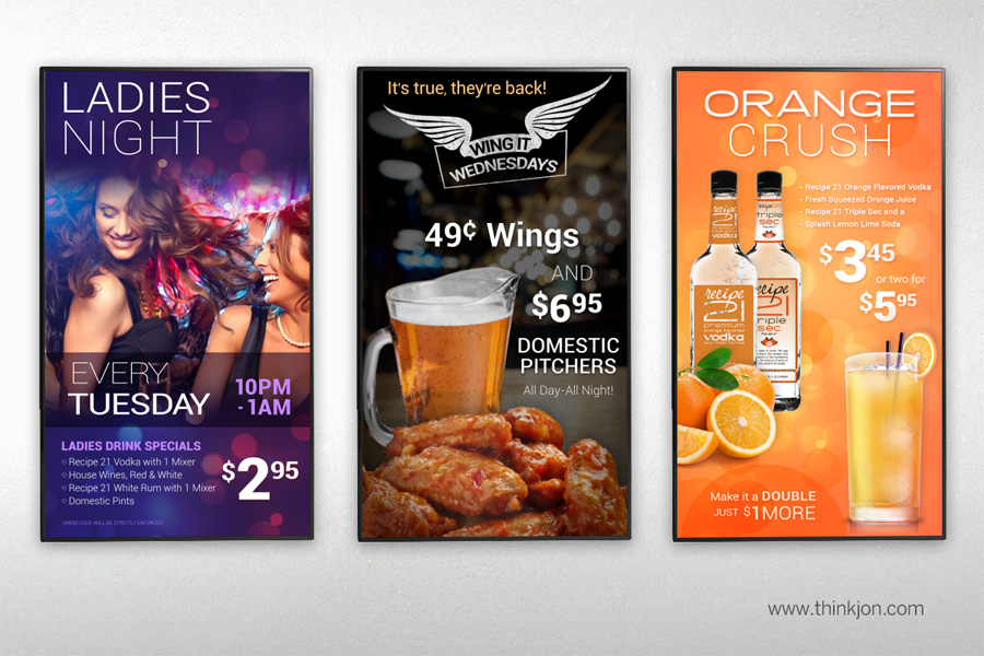

We’ll look more into the datasets, when we realized the output was tabular formatting only we didn’t see it as a solution. With the Ticker, perhaps it could work. There’s only 2 ways to extract data is the Ticker Module and the Dataset module itself. Is that correct?
We understand you can’t share the visual examples, however, did the the client you mentioned have to use the Ticker Module for outputting their dataset content or code a custom module for their dataset output?
Please keep in mind, our interests are not just for menuboards, that’s only one form of design work we provide. The ticker may just work for another form of design we do, promotional sales for clients in-house marketing. Although, even though it’s only typography there’s design involved with the CSS styles. The attached is a few type of digital-posters for various promotional sales marketing campaigns, bars and grills. Within these examples, only the text will be updated. The Region underneath is a video playing.
Please let us know if they had you you mentioned. This might be what we are seeking. You got us thinking about the Ticker/Datasets.
Thanks again Alex - your help is GREATLY appreciated!
If we were doing it we’d develop a custom module in most cases, but ticker would get you 90% of the same functionality.
Of course you can add or remove items! Keep in mind though that formatting 20 items vs 3 on a screen is a very different proposition so you will have to impose some limits to keep things looking good.
The three poster example you show though is absolutely prime for a dataset ticker. You just place the ticker where you want the text to appear, format the merge fields, and limit the ticker to show only the appropriate item on the appropriate row of the dataset.
