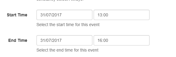

i have a player with default layout and a scheduled layout but the scheduled layout is not running as scheduled :frowning:
Here is how,
Scheduled to display from 31.07.2017 - 31.08.2017
Starting hour: 13:00 and ending hour 16:00
It is showing it all the time with the default layout.
What am i doing wrong?

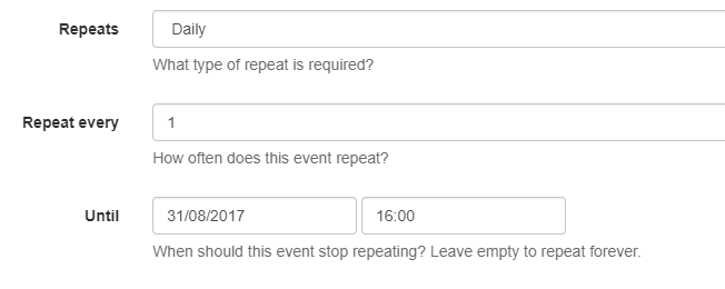

Right, the default layout (id 151) looks fine, the scheduled layout (id 162) seems to be scheduled a bit differently from what you’ve described.
as it’s <layout file="162" fromdt="2017-07-30 17:30:00" todt="2017-08-25 18:15:00" scheduleid="115" priority="0">
Which would explain why it’s always on the screen cycling with the default layout.
So, you will want to have it
With Repeat:
Alternatively since it’s 1.8 cms/player, you can create a daypart 13-16 and use that daypart in the schedule

If it should be displayed only between specified timeframe each day, then you will be looking at my example with repeat each day.
There were quite a few issues with dayparts in 1.8.1, if you’d like to rely on them I’d strongly suggest upgrade to 1.8.2 first.
As for more in depth explanation about dayparting please see http://xibo.org.uk/2017/07/26/scheduling-your-content-with-dayparts-in-1-8/

You’ve set it to display
from 30-07 17:30
to 25-08 18:15
So that’s exactly what it does now, it will show this layout until 25-08 18:15.
As I’ve already said, you will want to use daily repeats for this event
ie
start 01-08 17:30
end 01-08 18:15
repeats tab
repeats Daily
repeat every 1
until (presumably) 25-08 18:15

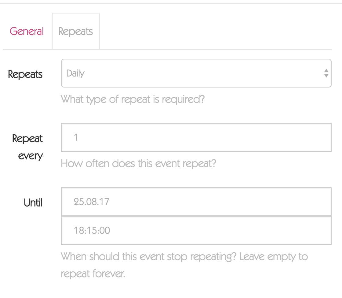

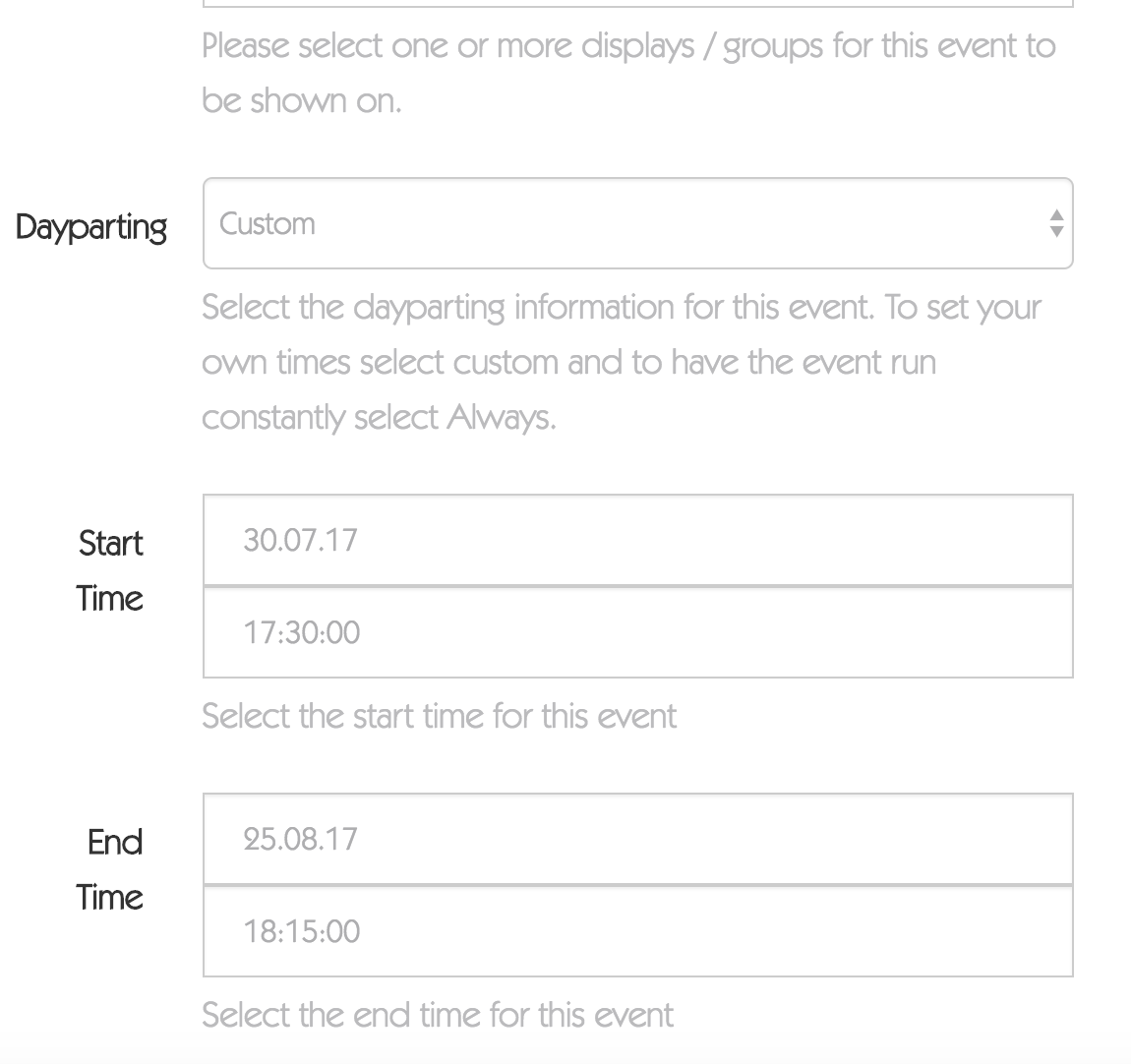

Hi Peter,
please see the images,
from 30.07.2017 starting at 17:30
to 25.08.2017 ending at 18:15
What is happening here is that,
system is showing the schedule whole day long.
It is not respecting the hours at all :frowning:
The schedule is supposed to end now but still playing it :frowning:
It’s suppose to end on 25.08 as you’ve specified.
With this configuration there is absolutely no need for repeat too.
Please try to set it as I’ve mentioned earlier.
I am completely lost now :frowning:
when i look at the pictures you have posted,
i did exactly as in your pictures and the scheduled which is supposed to work as scheduled event is shown forever.
I am not trying to show the content just between 30.07.2017 - 25.08.2017 in 24 hours period, i want to show it daily only at 17:30-18:15 during the period of 30.07.2017 - 25.08.2017
When the system shows it for 24 hours with out respecting the hours i have set,
i see no point of this schedule because it is not a schedule at all it is just set to play 24 hours inside of a period which is not my goal at all.
I am sorry :frowning:
please explain,
what am i doing wrong?
Here is what i expect and how it should work,
I set the time period which is 30.07.2017 - 25.08.2017
I set the daily hour period which is 17:30 - 18:15 which means, this content should be visible only 45 minutes/day not 24 hours/day.
I hope i have explained clearly now.
@Gyro,
You need to set the time period for a single day, so if you were setting it up today it would be 01.08.17 13:00 for start time end 01.08.1716:00 for end time and then have it repeat daily through 25.08.17 if that is when you want it to stop. (Or 17:30 - 18:!5 as you later indicate)
What you have done with the 30.07.17 start and 25.08.17 end is create a window of operational time from 17:30 on the 30th of July to 18:15 on the 25th of August. The layout will display constantly for that very large window of time (multiple days) as you have told the system to do exact that.
As Peter has said, the system is working as expected.
I hope that my slightly different explanation of what’s happing helps you understand the reason the system is doing what you’ve told it to do and not what you expect it to do. Computers are wonderful at doing exactly what you tell them to do, but not real good and reading into your intent and doing what you really wanted done. :slight_smile:
