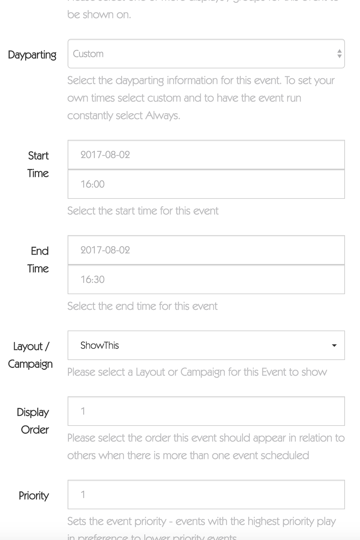

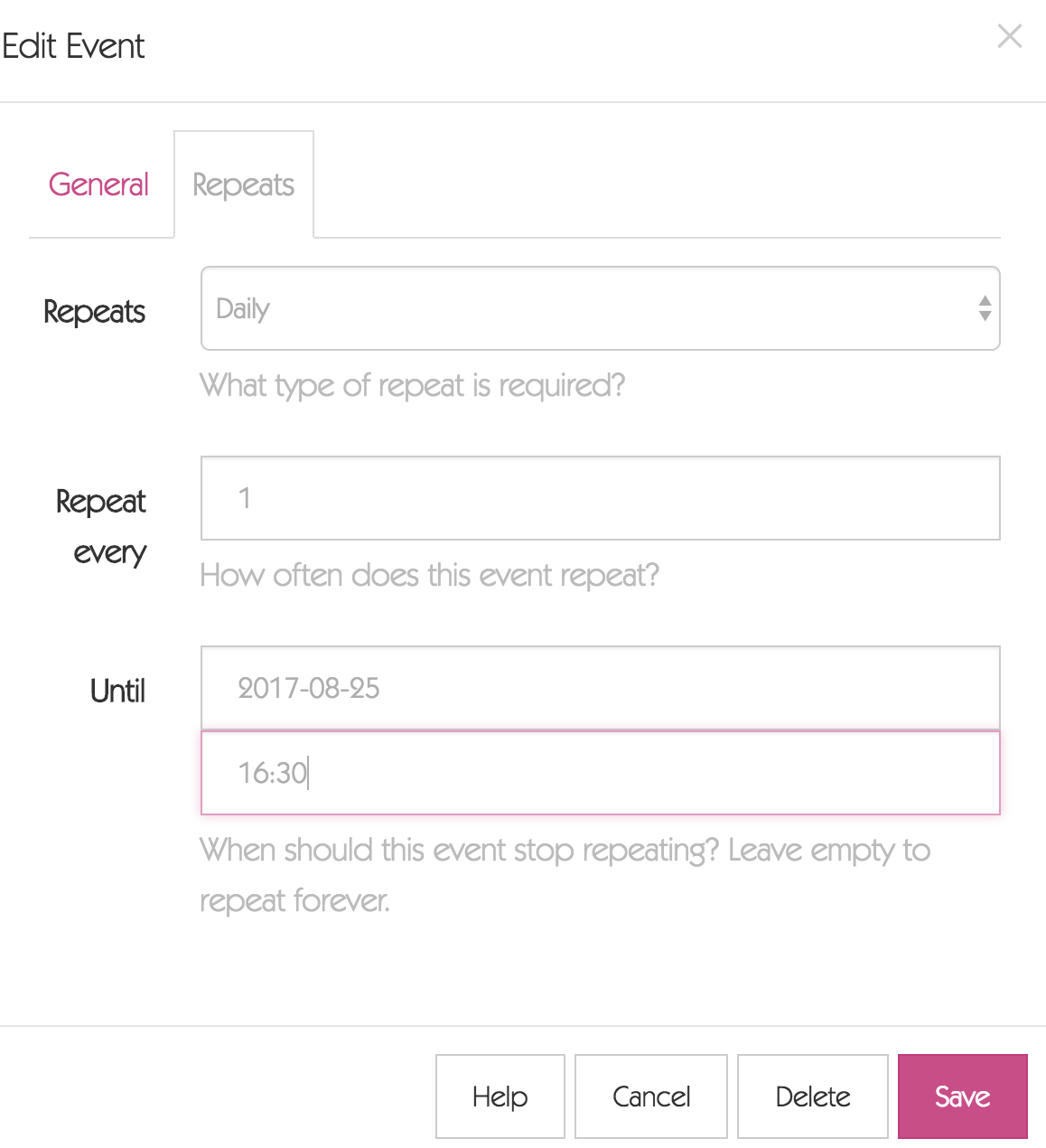

“You don’t need to use a daypart at all, if you notice Peter’s example above, it’s set the schedule for the time frame within the day you want the content shown, (as you originally specified, 13:00 - 16:00) for a single day (30/07/2017), and then use the repeat tab to have it repeat that schedule daily until 25/08/2017.”
I did this and it does not work. It kept playing before the time was started and kept playing after the time was ended. Which most likely is a bug in 1.8.1
Ok, it’s obvious that you are not going to see the error in your logic when it comes to the scheduling aspect of Xibo CMS. I would think the staff of the company that develops the system would know how it works. If you have seen other systems that work as you describe, than I would respectfully suggest you get one of them working and use it. You are simply not grasping the error in your logic when it from the start date/time and end date/time. I’ve tried my best to explain it, and I have failed. For that I am sorry.
I also do not believe you have setup the layout exactly as Peter described and I tried to explain from a slightly different point of view. I would be willing to bet money if you set it up as Peter’s screenshots show, it would work as you expect and not as you have told it to.

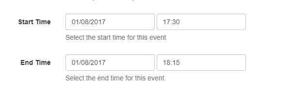

The scheduling could be much simpler and easier without having any extra work. It could be like i have been trying to describe: Start date: xxx End date: xx should set the the date period and Start time: xx End time: xx should start the time period which was a suggestion and has been a suggestion all the way long. This will make the scheduling easier and simpler for the users. I hope this could be considered in up coming versions. This has really got nothing to do of me listening what you or someone else said, because i have been listening all the time and doing exactly as advised.

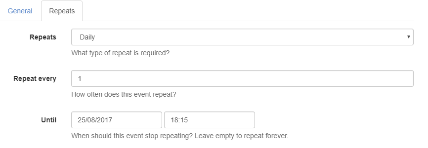

The suggestion which you have made originally and making now also in your latest post, does not unfortunately work. I am probably not able to explain which i have tried several times. When i do exactly as you say, the media which is scheduled to be displayed in Windows 7 client starts playing immediately and does not stop when it should.

Okay,
I have found the problem!
After clearing the cache and rebooting the player, i re-created the schedule and wait for it to start. It never started.
I rebooted the player again and it didn’t help, my schedule simply won’t start.
I have cleared the cache and re-created again by setting a new time schedule and the result was same.
I have sent another schedule which had no specific hours (regular schedule with priority), it started to play as scheduled and worked.
I have closed the CMS waited about 30 minutes and reopened it. Went to the schedule where i have specific hours, opened it and pressed save again and BOOOM! it started to show the right schedule.
Than i have waited for the schedule to see if it ends as scheduled, it did.
Now,
the problem seems to be,
when it is saved once, it doesn’t seem to be validated to the player somehow but when saved second time, it goes to the player and works.
I was able to do this test 3 times and i got it work each time after saving second time.
It seems to behave in exact same way with both Windows 7 and Windows 10 clients.
