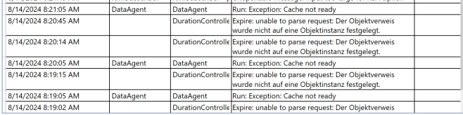

I removed the WeatherWidget again, but it did not helped. I still get again:
  • DurationController: Expire: unable to parse request
  • DataAgent: Run: Cache is not ready
A RSS Feed Displays ok, but two other Data lists are showing “no data” when there IS data.

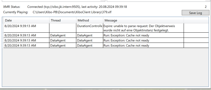

I reinstalled the player and it seems to work now. However I still have these log entries when I change the layout. (in this example I added the flip clock). The datasets immediately started to show “no data available”.
grafik
The CMS logged this events:
After few minutes errors went away and now it seems to work. Thats weird.
