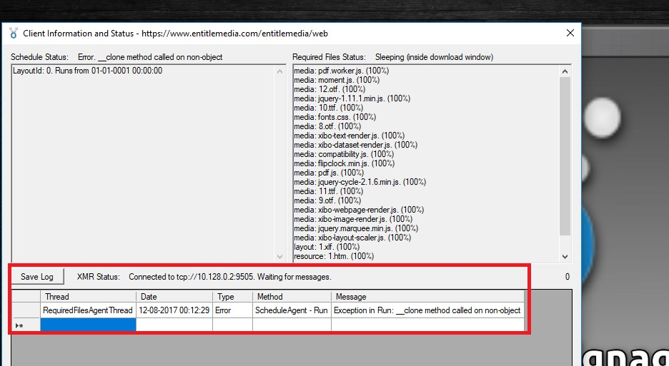

Hi Dan/Alex,
I am getting the following errror when I Launch my player.
Is there any idea what caused it or is it a Client side or Server side error? …

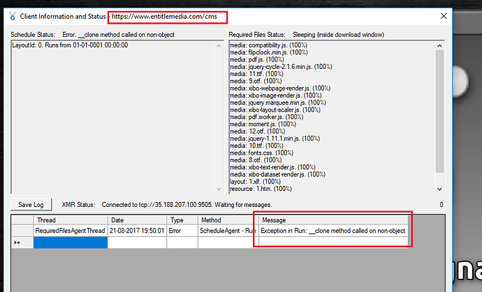

This is the exception I am getting
Exception thrown: ‘System.Web.Services.Protocols.SoapHeaderException’ in System.Web.Services.dll
Error: 2017-08-12 01:00:33RequiredFilesAgentThreadScheduleAgent - RunException in Run: __clone method called on non-object
You seem to have /web in your CMS address, if even player access it like that, which implies configuration error, as I said before, please read http://xibo.org.uk/manual/en/install_environment.html
