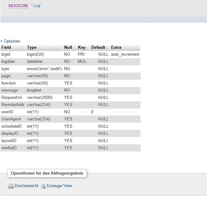

So longtext for the message field is correct and should allow 4MB of text per entry, yet in your log it’s getting cut off after a few hundred characters which means we can’t see what the CMS is returning. Without that information it’s going to be hard to help you further I’m afraid.
