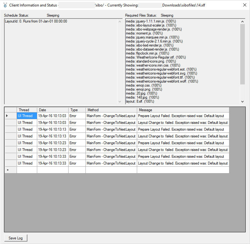

I installed Xibo on my webserver. I made a test setup with two layouts and try to schedule it but for an unknown reason the player doesn’t dowload the scheduled layouts. Even a little change in the default layout won’t be picked up by the player.
I checked several things which i read from other topics ::
  • Checked the modules
  • Checked if there is a time frame for downloading content (in my case it’s 00:00 to 00:00)
  • Set the time to 1 minute
My player and my CMS are both 1.7.7.
A screenshot of my player is enclosed.

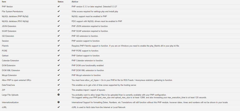

Any [X] on Report fault page? Any other errors in logs?

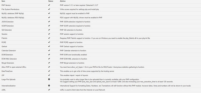

I made a print of the report screen. Beside the internationalization and file size , i don’t see any problems.
