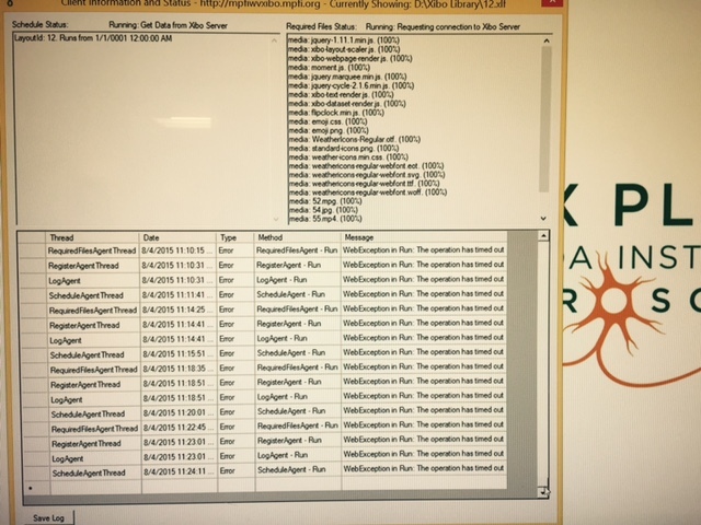

All my players get the “Download file failed MD5 check” error, even though they’re all displaying content just fine. Below is the log.
I’m running xibo cms 1.7.4 and I tried the the patch posted here: Downloaded file failed MD5 check, no luck - this one actually started giving me different errors.
Any help would be much appreciated.
Here is a sample of the log:
ScheduleManagerThread|7/23/2015 9:24:26 AM|Error|ScheduleManager - LoadNewSchedule|Layout invalid: 0
LibraryAgent|7/23/2015 9:24:26 AM|Error|LibraryAgent - Run|Exception in Run: Could not find file ‘C:\Xibo Library\requiredFiles.xml’.
UI Thread|7/23/2015 9:24:26 AM|Error|MainForm - ChangeToNextLayout|Prepare Layout Failed. Exception raised was: Default layout
UI Thread|7/23/2015 9:24:26 AM|Error|MainForm - ChangeToNextLayout|Layout Change to failed. Exception raised was: Default layout
FileAgent_media_Id_9|7/23/2015 9:24:27 AM|Error|FileAgent - Run|Downloaded file failed MD5 check. Calculated [d41d8cd98f00b204e9800998ecf8427e] & XMDS [ 3c9137d88a00b1ae0b41ff6a70571615] . jquery-1.11.1.min.js
FileAgent_media_Id_10|7/23/2015 9:24:28 AM|Error|FileAgent - Run|Downloaded file failed MD5 check. Calculated [d41d8cd98f00b204e9800998ecf8427e] & XMDS [ 3659986d00e56c929218084aeb991cca] . xibo-layout-scaler.js
FileAgent_media_Id_11|7/23/2015 9:24:28 AM|Error|FileAgent - Run|Downloaded file failed MD5 check. Calculated [d41d8cd98f00b204e9800998ecf8427e] & XMDS [ d59f5fc84ef7747f27baddc07fe81487] . xibo-webpage-render.js
FileAgent_media_Id_12|7/23/2015 9:24:28 AM|Error|FileAgent - Run|Downloaded file failed MD5 check. Calculated [d41d8cd98f00b204e9800998ecf8427e] & XMDS [ 67bb26c11dba6c366834e65f5933aff2] . moment.js
FileAgent_media_Id_26|7/23/2015 9:24:28 AM|Error|FileAgent - Run|Downloaded file failed MD5 check. Calculated [d41d8cd98f00b204e9800998ecf8427e] & XMDS [ c90a4c420dd010a5e95dedb8927a29e7] . weathericons-regular-webfont.woff
FileAgent_media_Id_13|7/23/2015 9:24:29 AM|Error|FileAgent - Run|Downloaded file failed MD5 check. Calculated [d41d8cd98f00b204e9800998ecf8427e] & XMDS [ 2286bb4f44d9ea301131a25c5204ca0a] . jquery.marquee.min.js

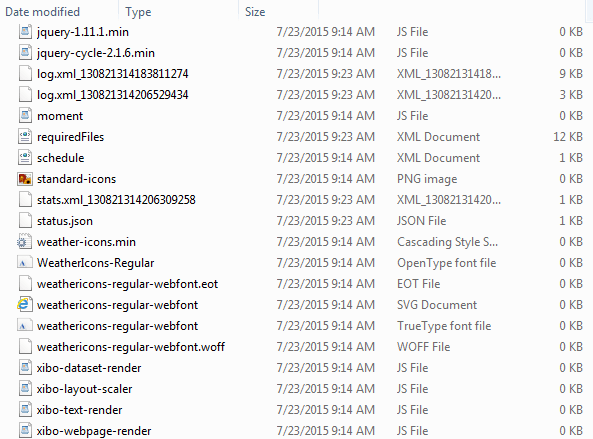

Did you by any chance changed the player local library folder?
If I am not mistaken it should be by default in …\Users\USERNAME\My Documents\Xibo library
It looks like you changed it, and player can’t find required files (and literally requiredfiles.xml too :smile: )
Your current layouts will play just fine from the cache, but any changes to those layouts and/or new layouts will not play correctly.
This means that we downloaded a file from the CMS but it was corrupt in some way. The most frequent cause for this is:
Incorrect setting for File download mode (SENDFILE_MODE) on the General tab in the CMS settings. Ensure that’s set to Off unless you’re sure your webserver supports that and has been configured specifically for that as well.
Files in the Xibo Library folder on the CMS being deleted or modifed directly (rather than through the Xibo CMS interface). Ensure you never manually delete or change files in the Xibo CMS Library folder directly.

All your calculated MD5’s are the same - and I suspect this is because the file it receives is empty. Can you try the “Verify All” routine in the Modules section of the CMS to ensure those files mentioned are available in the CMS library?

The files are being read just fine from the local directory, so I’m not sure if it’s a permissions issue.

Yeah, those are the files that get put their by the installer / verify all routine.
It looks to me like you have your Player and CMS libraries in the same location - which wont work. They must be in separate locations. (either that or your screenshot is from the Player).
No they are in separate locations. I think originally I may have pointed them to the same location, but that never went anywhere. I should also say that the same files for the players have correct size and contents. Should I change the save location for the CMS to something else?
Are you sure you aren’t getting the two locations mixed up? The player downloads files from the CMS, not the other way around - if the CMS has 0KB files, then the player will do to.
Can you delete those empty files and run the verify all routine as before. If the files don’t come back full, then the CMS can’t write to that location properly.

Windows doesn’t have problems downloading stuff from the CMS, but after changing the location of all the players from network to local, the MD5 check sum error no longer appears. I am seeing quite a few WebException in Run type of errors. Here is a screenshot. Some of these are wireless, some are wired. As far as I can tell, their have good connectivity. Maybe you have some thoughts?
Ok, so now CMS and players are in the same local network, I assume that in player’s local library everything looks better now ie. there are actually required files with a bit more than 0kb size? :smile:
How does it looks like in the CMS? Are the devices correctly shown there as logged in and up to date?
When you close and reopen client is it still showing those errors?
Other than that I think we will need to see the logs as my previous post here:
