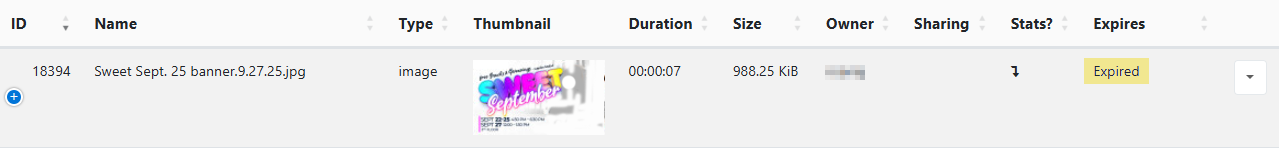

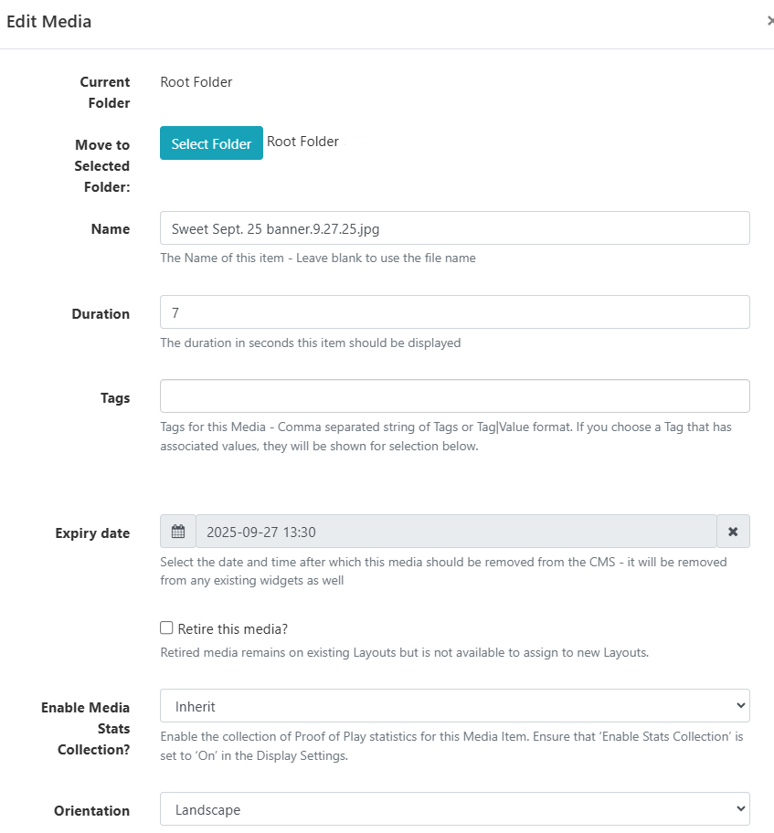

Hello all. We appear to be having an issue when it comes to media not being erased from the CMS one expired. The media is simply marked as expired, but is still in the media library. I have attached some screenshots below.
Also, to confirm, does expiry in this case mean deleted from the media library as well? Not just removed from any layouts/playlists? The text in the CMS says it removes it from the CMS completely, but the Xibo documentation says it only removes it from playlists/layouts with no mention of CMS.

In settings there is option under “Defaults” tab:
Default ttl, in days, for records in purge_list table: [7]
Entries in purge_list table with expiry date older than specified ttl will be removed.
Default is set to 7 days it seems.
Thanks for the heads up @0x0
I’m aware of an issue in 4.2 where expired media items are not being deleted. This issue is ongoing and expected to be resolved in 4.3.1. Here is a link to the Github issue report so you can track its progress:
