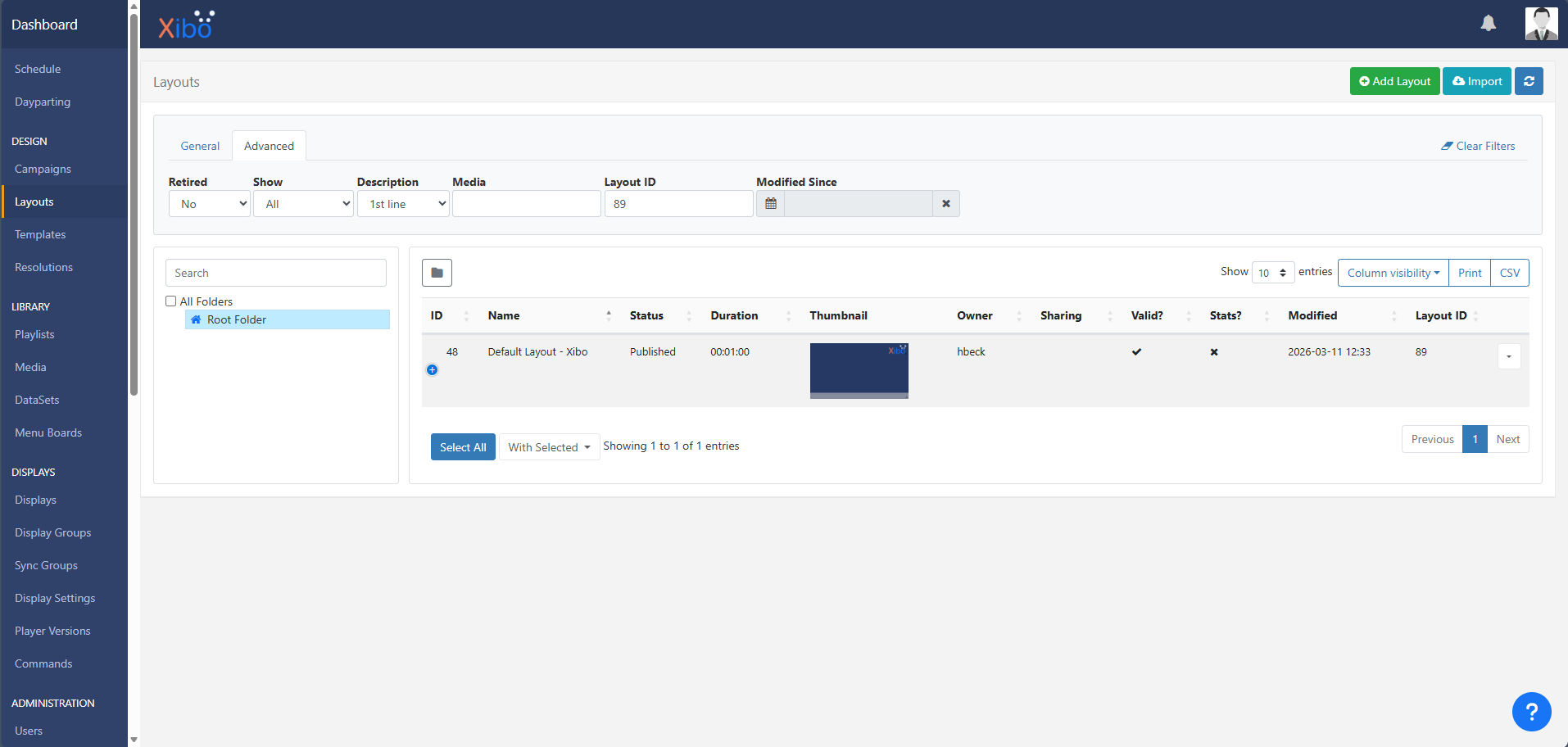

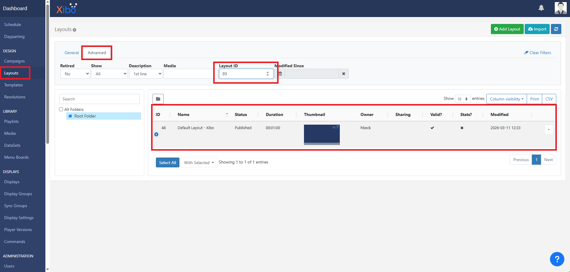

Hi Hannah,
You can filter out the Layout ID when you go to the CMS, Layouts, and then go to the Advanced tab. Could you please confirm that you are not seeing the layout with Layout ID 89 on that page?

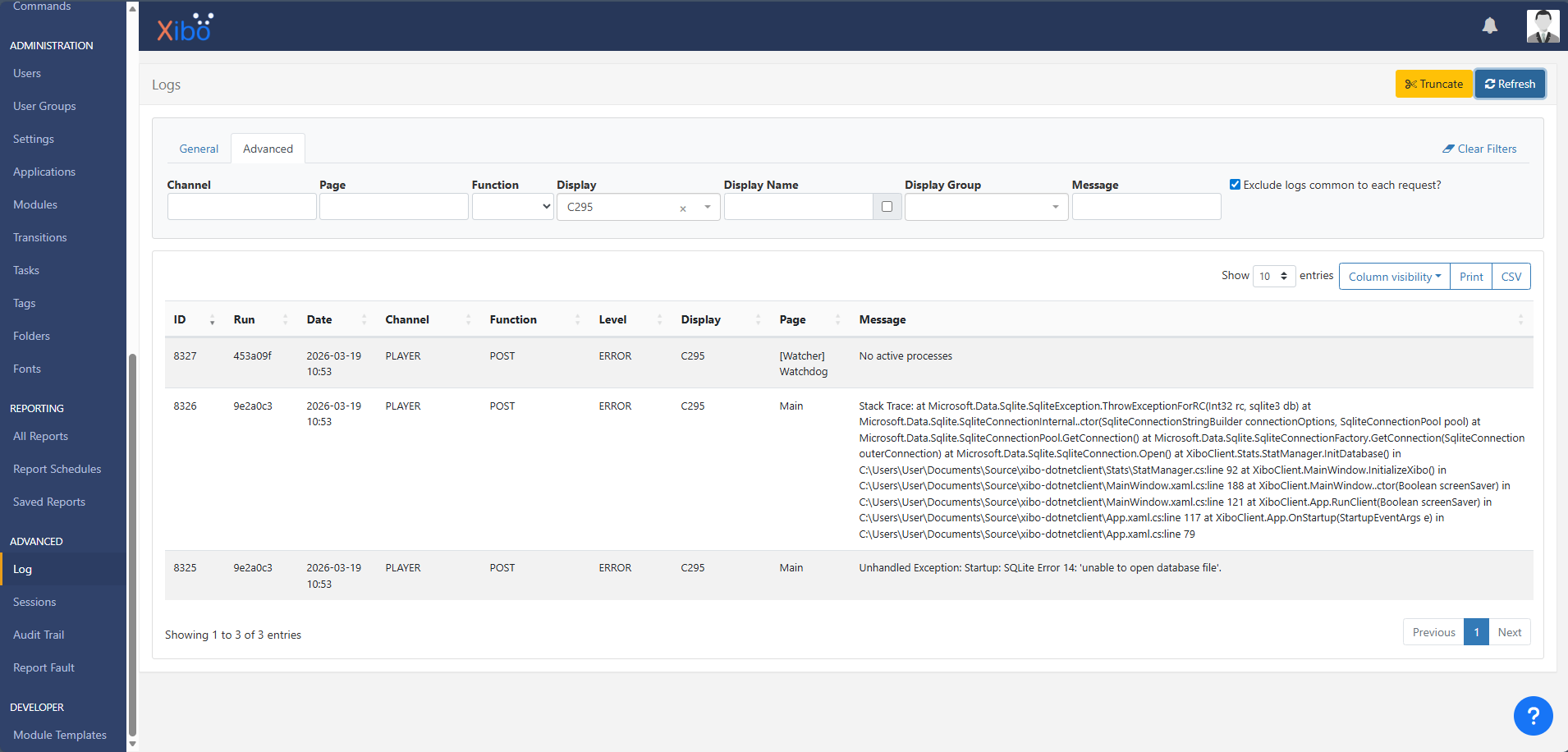

Hi Hannah,
I’ve noticed that there was an error in the logs for the ‘Report Fault’ that could be triggering the issue; it is highly possible that some tasks are not running correctly, preventing the player from downloading the dependencies. Could you please check and perform the below steps for me?

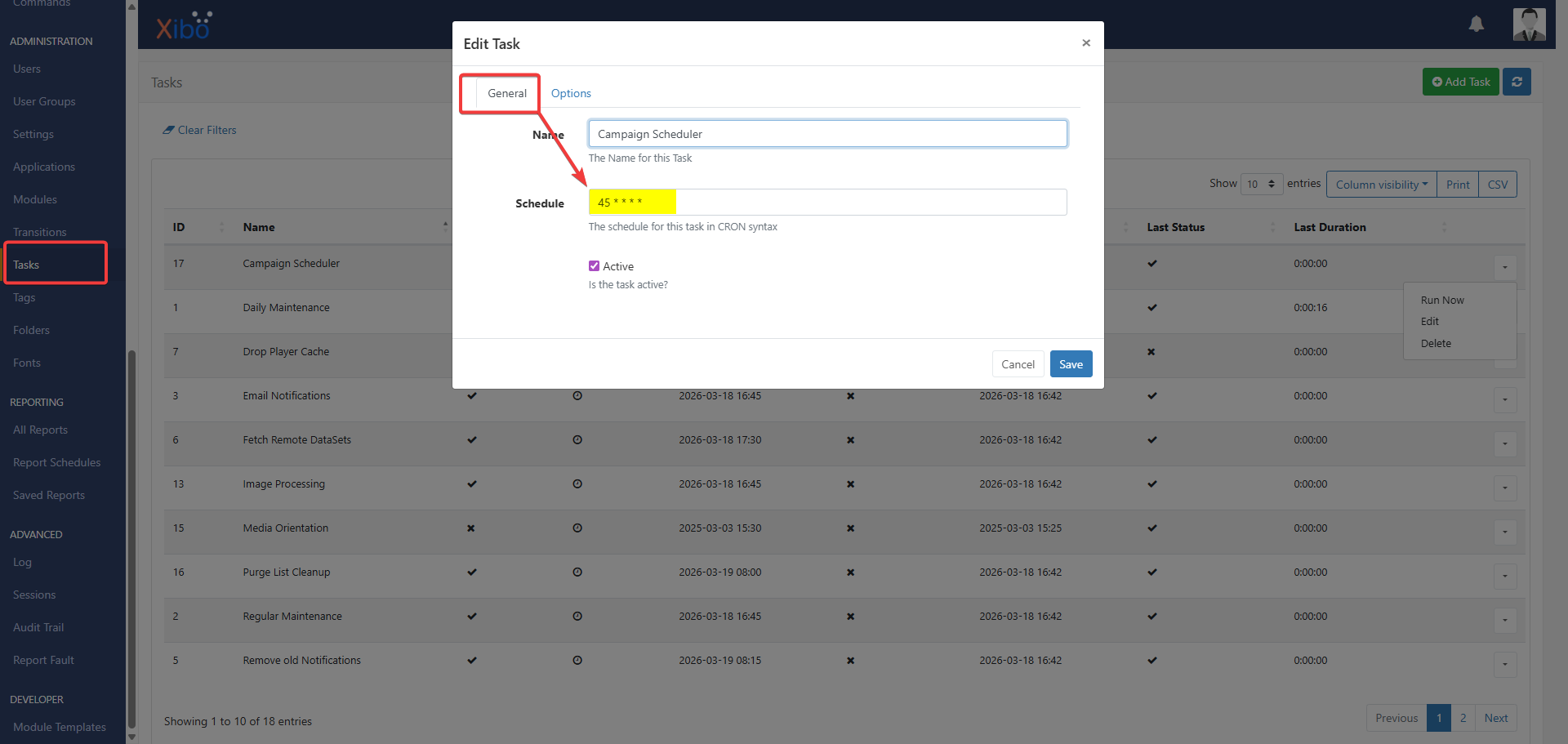

If you go to CMS, Task section, then click on the row menu of a task, you should see in the ‘General’ tab the ‘Schedule’ field. There would be numbers and asterisks separated by a space in that field. Please note that each block is separated by a space. Please check if there are tasks that have 6 blocks in them. Remove the 6th block/asterisk so that it will only be 5 blocks. Please take note of those tasks that have 6 blocks in them.
For example:
Below we see, 45(space)asterisk*(space)asterisk(space)asterisk(space)*asterisk(space). The bolded ones are blocks separated by a space where we see that there are 5 blocks..
We can observe that there are 5 blocks for this example and nothing to do with this one. We are looking for tasks with 6 blocks.
Example of what we are looking for: we need to delete the 6th block.
This issue has been identified already as a bug and will be fixed in the CMS V4.4.1 release; however, the above workaround was found to fix the issue. You can view the bug post here for reference.

Hi Jerry,
Thank you for responding.
I’m seeing the “Default Layout - Xibo” appear when I filter by Layout ID 89, even though the ID shown to the right of the layout name is 48.
I found a few tasks with extra blocks and removed them as suggested. Those tasks and what they were and changed to include:
  • Remove Old Screenshots 0 0 * * * *0 0 * * *
  • Report Schedule */5 * * * * **/5 * * * *
  • Sync Dynamic Playlists * * * * * ** * * * *

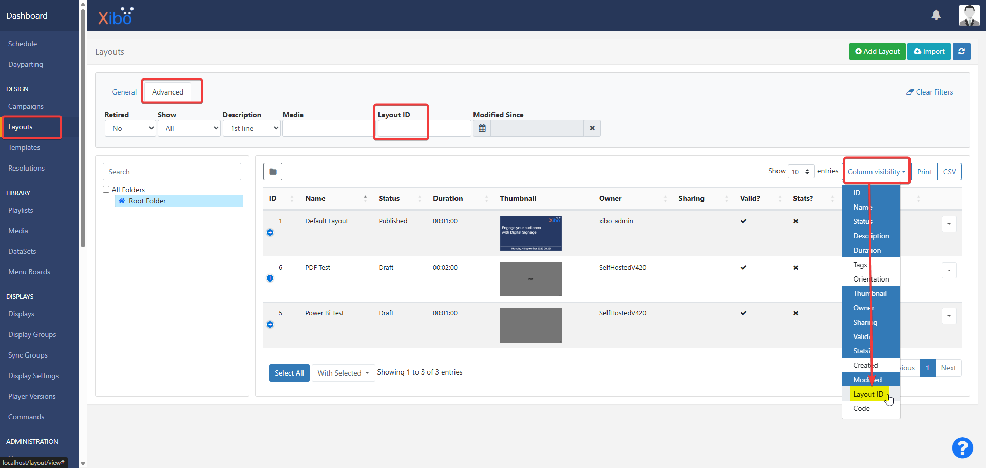

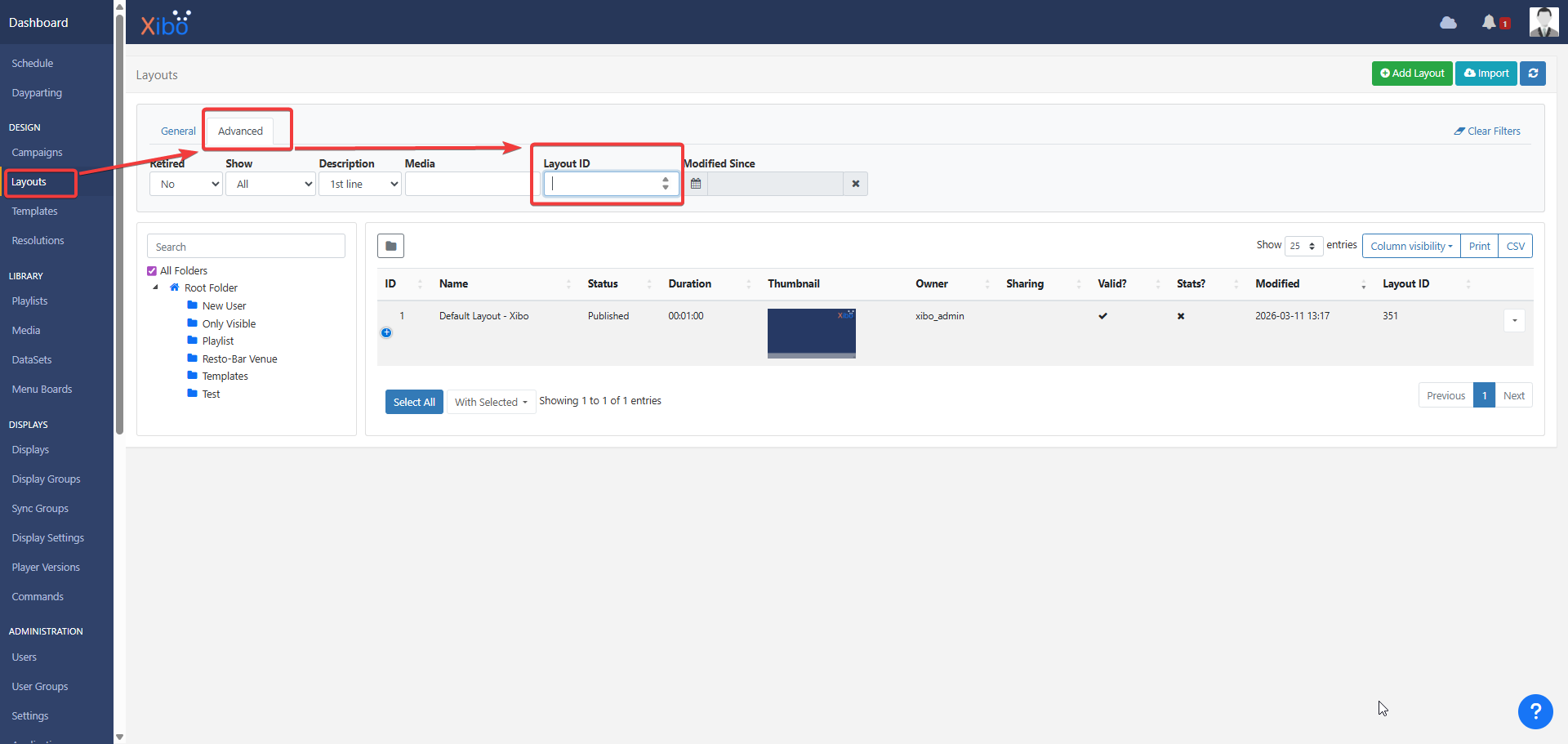

Hi Hannah,
To show the Layout ID, on the CMS Layout section, please click on ‘Column Visibility’ and then click to select ‘Layout ID’, this will show a column for a Layout ID, and please confirm if the Default Layout I sent you shows a Layout ID of 89.

Hi Jerry,
I have confirmed the default layout you sent me shows a Layout ID of 89.

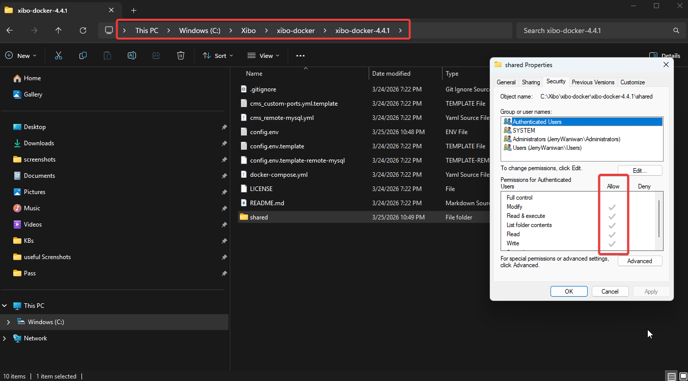

  2. Make sure to close the player and then go to your Xibo installation directory. It is recommended that the installation directory should be in the root of your drive. In my case it is in the root of my C drive. Go inside the Xibo folder and you should see the ‘Shared’ folder. Please create a backup first for the ‘Shared’ folder. Could you check if this folder has all permissions? (especially the read and write permissions). To make sure, turn the permissions off and then save it. Go back again and turn on all the permissions and save it. Inside the shared folder, you would see the backup, cms, and db. Could you please make sure that all those 3 folders have full read and write permissions on them?

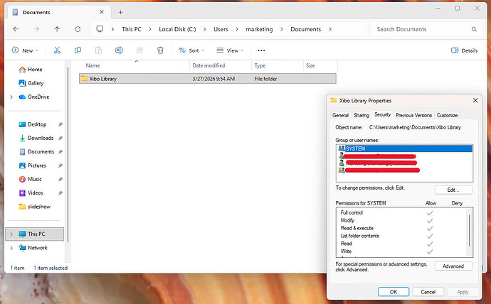

  1. Go to the player’s local library; normally the path is found in the Xibo player options, under the ‘General’ tab. Make sure that the folder has full permissions in it. To make sure, you can edit the permission and just like in step 2, turn off all the permissions, save it, then go back again and turn it back on, and then save it.

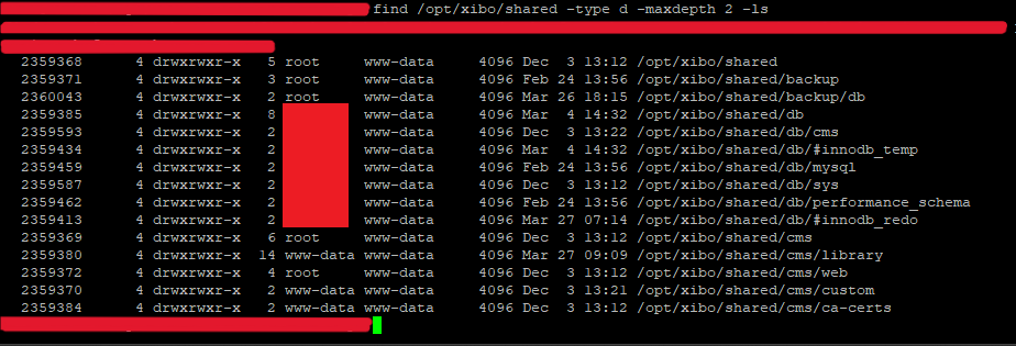

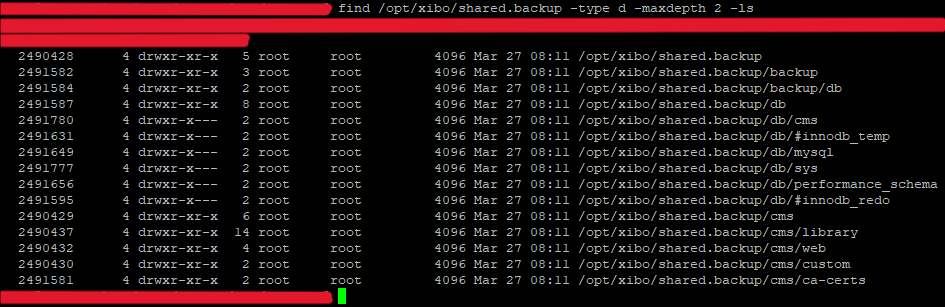

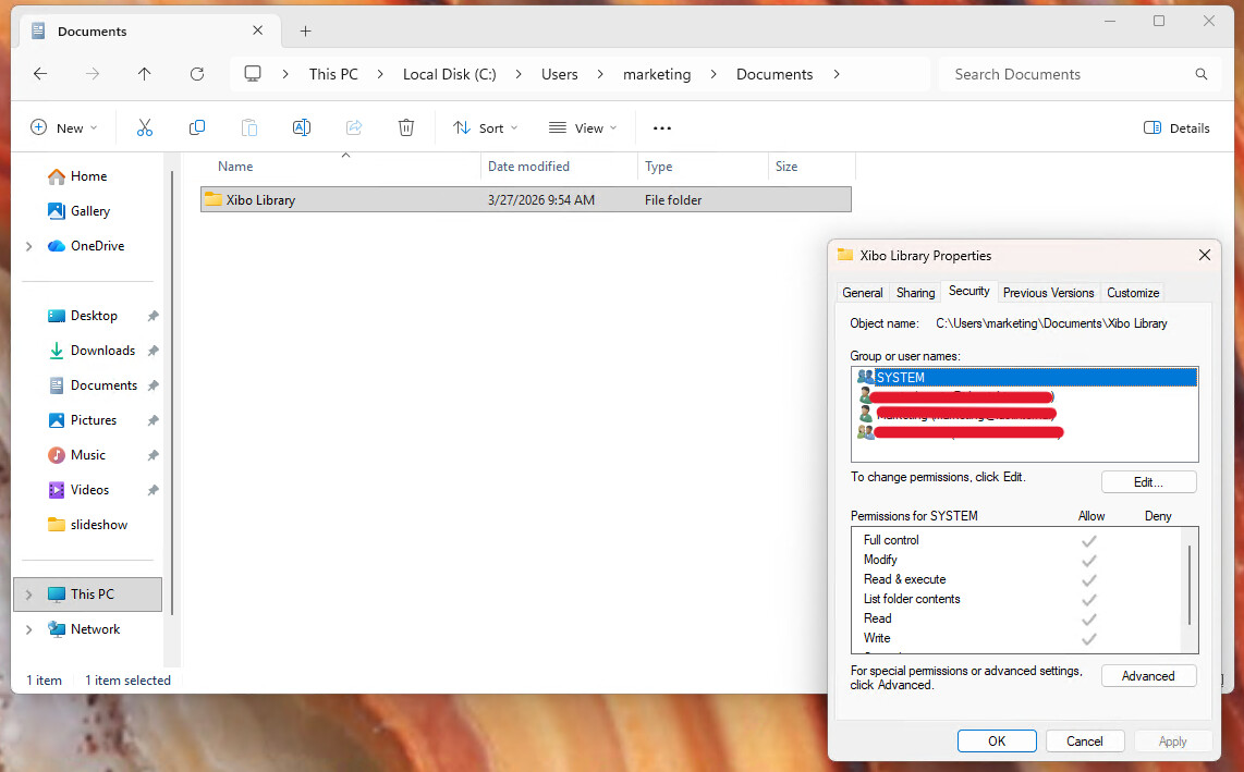

The Xibo CMS installation directory was created on an Ubuntu server under /opt. I updated the permissions so that www-data now has rwx access to the shared directory and all of its subdirectories. Previously, only root had rwx permissions, and all other users had only rx.
Xibo Installation Directory Permissions Before:
Xibo Installation Directory Permissions After:
Also, I verified that C295’s Xibo for Windows (XfW) local library had the correct permissions set.
I uploaded a simple image and verified it was present in the /opt/xibo/shared/cms/library directory. I then reconfigured XMR, launched the XfW Player, and waited. Unfortunately, the issue still persists. I will continue testing and isolating the issue by confirming whether it persists on another computer after copying the shared directory over.

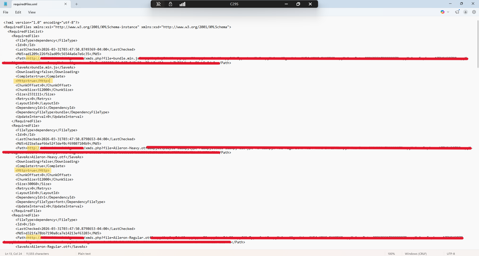

I’ve identified the root cause and resolved the issue. On the original CMS, both HTTP and HTTPS were initially enabled. At some point, HTTP was unknowingly disabled under the assumption that it was no longer in use. A few weeks later, when we attempted to update the videos on the Displays, they were unable to download the new content, including the bundle.min.js file. Removing the Displays from the environment made the issue worse, as they could no longer download any dependencies at all.
On the new CMS server, HTTP was originally enabled and then disabled in favor of HTTPS. Specifically, the default Apache configuration file (000-default.conf) under /etc/apache2/sites-enabled/, which allows HTTP communication, was disabled using a2dissite. A separate SSL configuration (default-ssl.conf) was then created to handle secure communication. Because we assumed HTTPS alone was sufficient, HTTP was fully disabled, which ultimately caused the dependency and content download failures. Having both HTTP and HTTPS enabled ultimately resolved the issue.
In summary, the CMS was attempting to deliver dependencies and content over HTTP. Because HTTP had been disabled, the CMS was effectively unreachable from the player’s perspective and could not fulfill those requests. What’s interesting is that when the XfW Player was initially configured, we provided the correct CMS address using HTTPS and were able to connect successfully. This suggests the initial registration process supports HTTPS, but the requiredFiles.json appears to explicitly reference file downloads over HTTP only, rather than supporting both HTTP and HTTPS. As a result, disabling HTTP prevented the player from retrieving its required dependencies and content.
