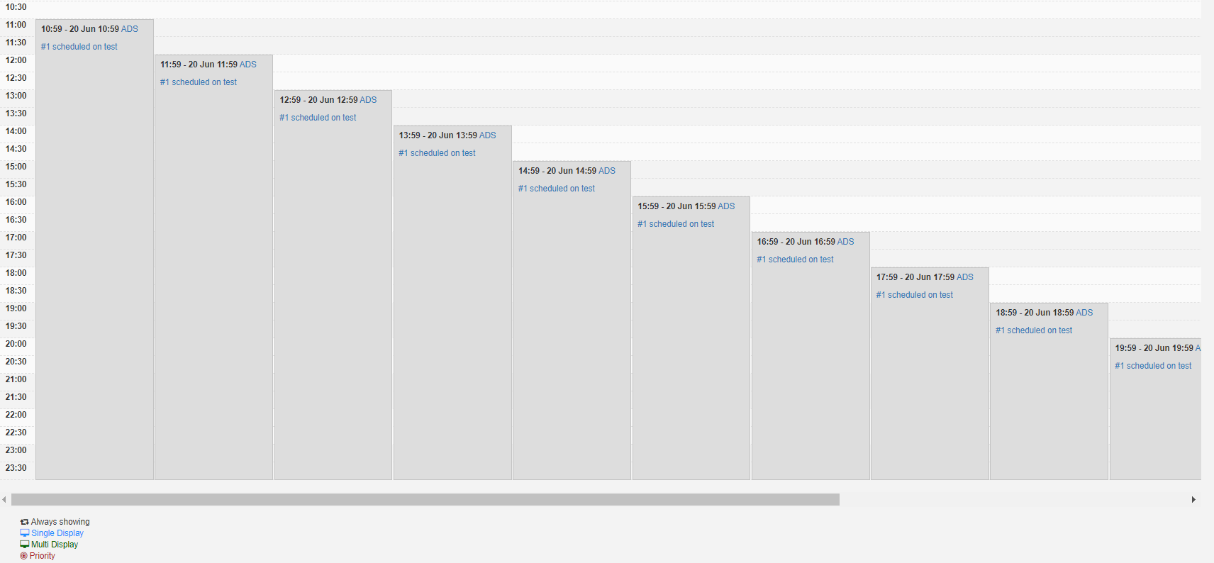

I also try this:
I have set repeating to 1 hour and this is the Agenda, same for every minute…:
Hi hypnomedia,
The reason that the campaign is playing constantly is because you have set the end time on the General tab to be 12 days from now. The end time on the General tab should be set to 1 minute later than the start time. If you then want the campaign to end on the 20th, you would specify this on the Repeats tab.
