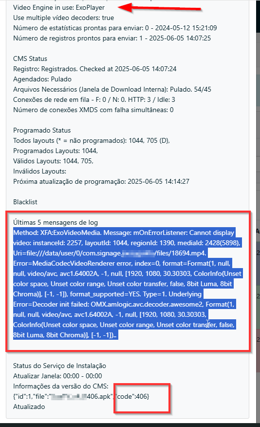

Bug XFA: Android R406 - Decoder init failed / video stops playing
Hi guys, hope you are well
Device: Amlogic S905X4 - Android 11
This problem that was seen in the R404 is now happening with the R406
The print shows exoplayer as the video engine that comes with XFA by default.
The video only starts playing again after restarting the device
Is there anything that me or Xibo can do about this?
Thank you!

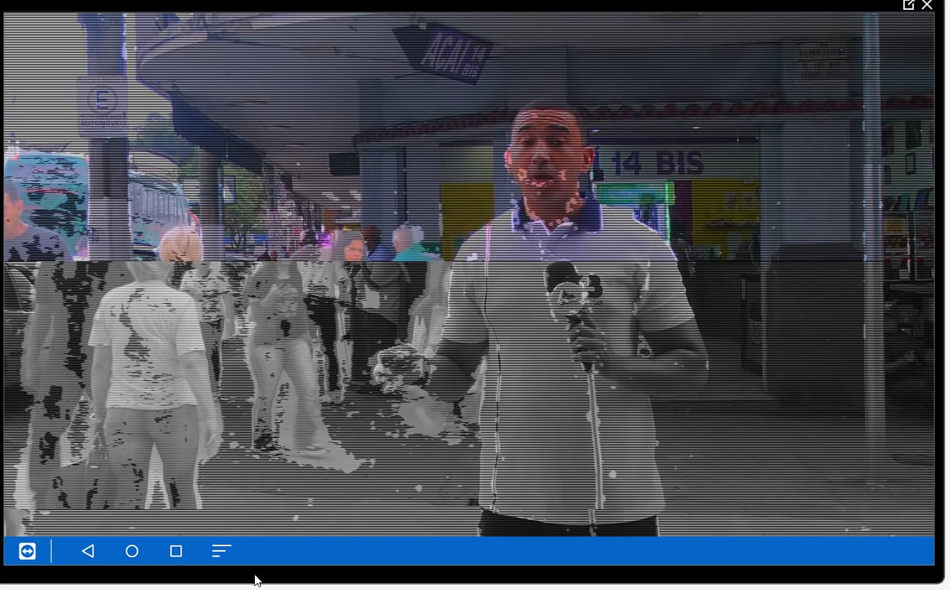

During testing, I noticed some limitations of the Xibo app for video playback on Android.
The same media below does not play correctly on the R406 (regardless of the video configuration used, Surfaceview, Multiple codec, Exoplayer or Android media player).

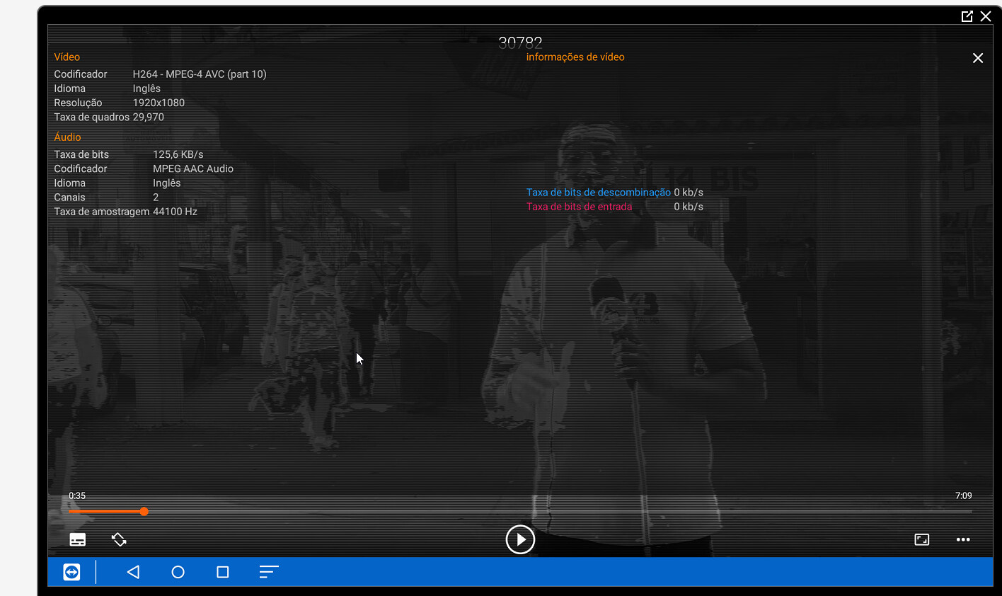

I used VLC (Android) as a comparison.

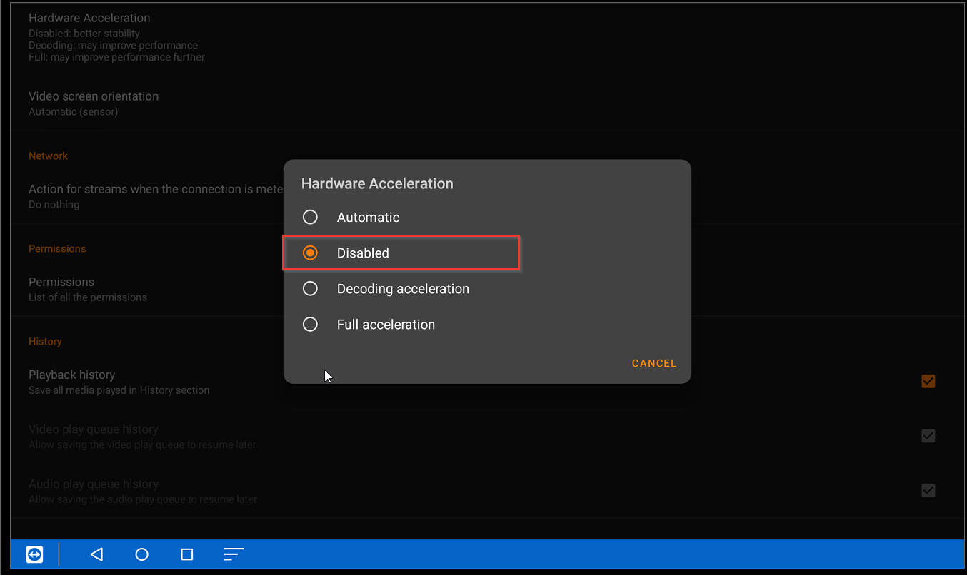

The media also behaved the same way, until I disabled hardware acceleration in VLC Android App.

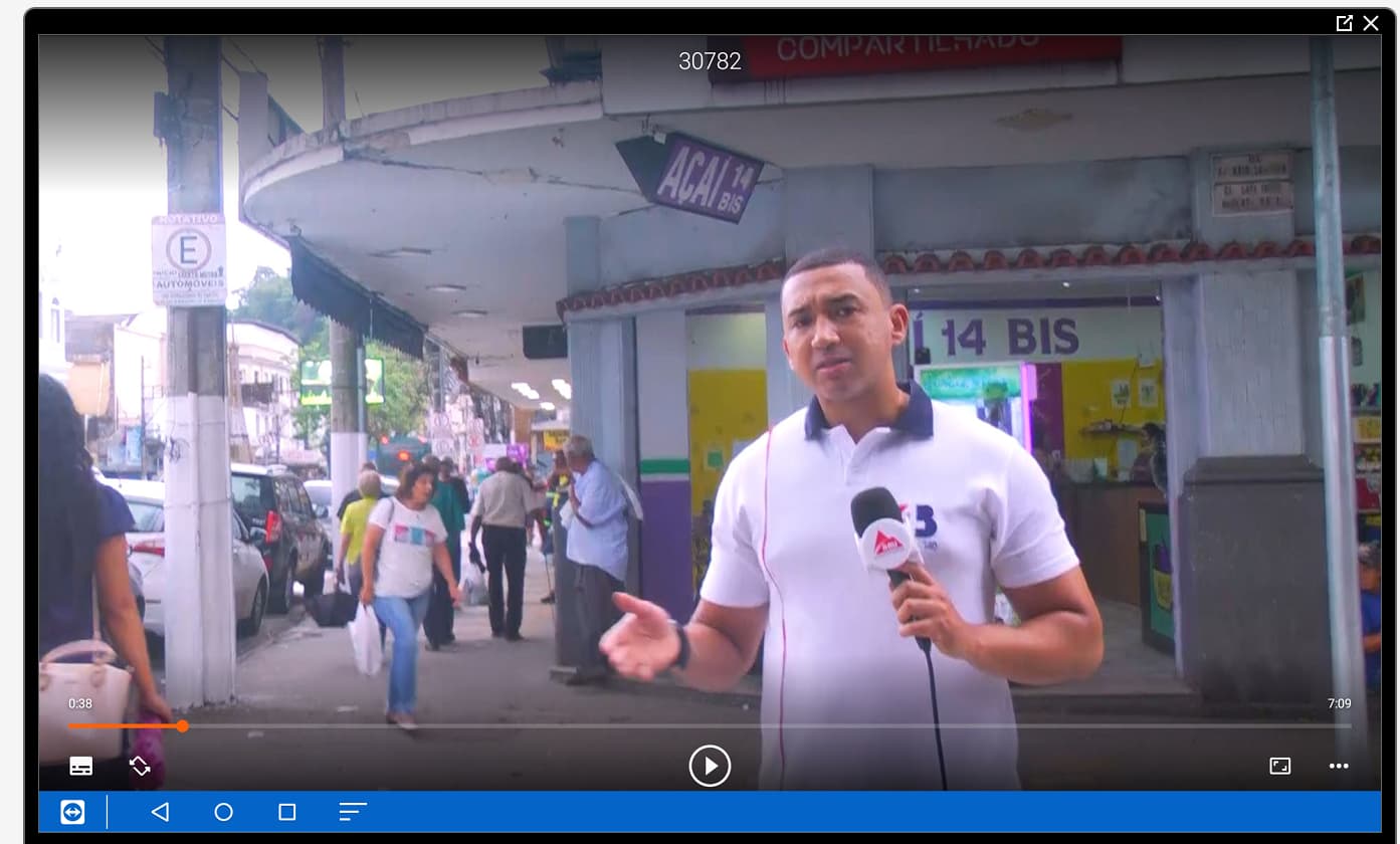

After that, the video started playing normally in VLC.
XFA - R406
VLC - Default Config
VLC - Disabled Hardware Acceleration:
@dan Is it possible to add this video configuration parameter (disable video hardware acceleration as in VLC) in the next version of XFA?
