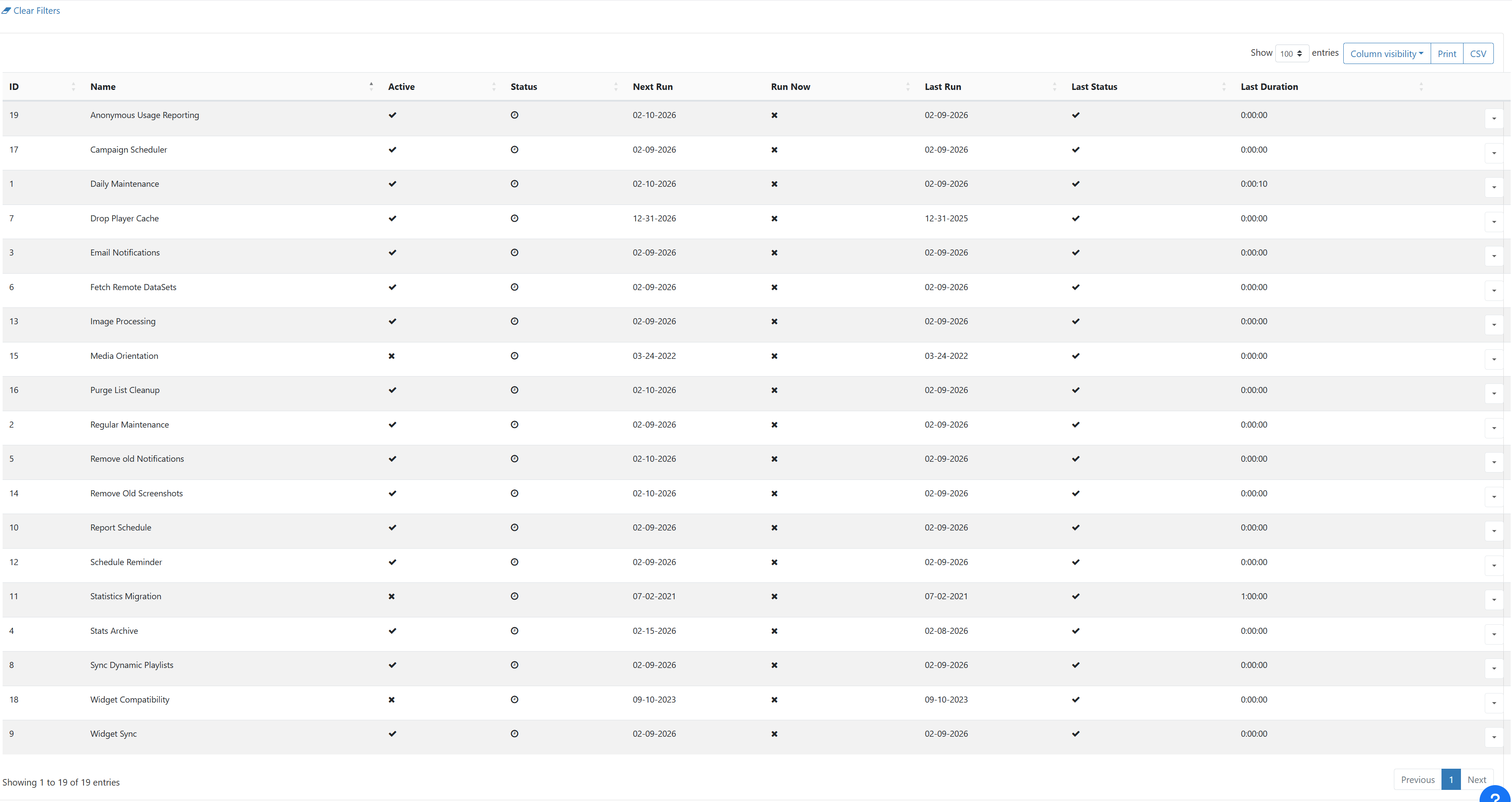

Can you check:
  • that the routine XTR tasks in the CMS is running (CMS screenshot of Tasks page - last run?) and that the CMS can reach the XMR API port?
  • Your access.log and error.log would help here
The XTR tasks are running.
I am not sure how to tell if the CMS can reach the API port but I can verify that in Resource Monitor that XMR is listening on that port.
