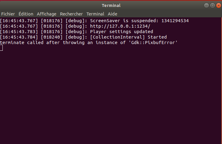

i try to run Xibo server and client on same computer under Ubuntu.
I have been able to install both and to connect client using “http://localhost” as server address but after that, client doesn’t look to run.
Did i missed something ?
Is this is an error ?
Thank you.

Can you confirm if the same issue is present if the Player is uninstalled and reinstalled? Also which version of Ubuntu are you currently using?
I have tested with another install and problem remain the same.
So, I confirm that I can’t run client on Ubuntu 18.04.3 LTS with CMS 2.1.0 installed with docker and client 1.8-R3.

Could it be a display problem ?
Here are graphic card details on 390 :

If you updated something, thank you.
I you don’t, i don’t know why but after fresh install it’s working fine.
Thank you for your message, the version of Xibo for Linux has not changed since the last release on 2/9/19.
It’s great to hear that a fresh install has resolved the issue, I wondered if you could confirm if your have a made any changes to the device, Ubuntu OS or player Option settings that might help to understand the change of behaviour? if you are aware of any differences with the setup, it would be great to know what they are so I can add them to the report.
I didn’t change much between the two orthers installations other than making update/upgrade of packages before all installation of Xibo and deleting shared/db directory since cms was in update statuts without reason.
Maybe there is an update in ubuntu itself that fix the problem.
