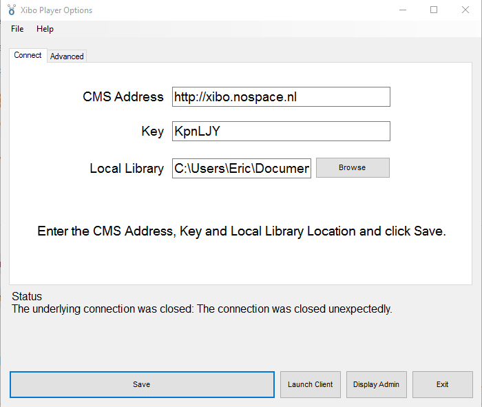

I downloaded the windows xibo client version 1.7.7 but when i try to connect i receive an error within my player.
My windows version in windows 10. I try to disable my firewall but the connection error remains

When i press the SAVE button then the errors occurs

i checked my windows firewall. For testing i completes turn it off. The error remains.
So i think it is not a firwall issue on my pc

when i press display admin it works.
when i press launch client it seems to work ( i see a xibo monitor)
When i click save i receive an error The underlying connection was closed: The connection was closed unexpectedly

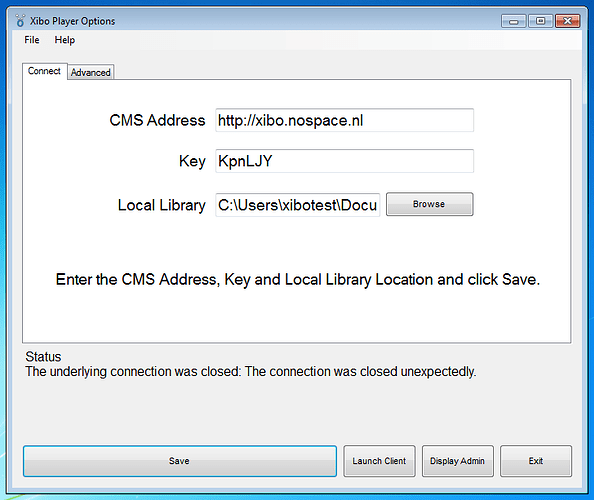

I’ll try a Player from here for you. The Player will run if it’s not registered with the CMS but it won’t be able to get any content to show.
I get exactly the same connecting to your CMS:
Something on the webserver side is closing that connection.
