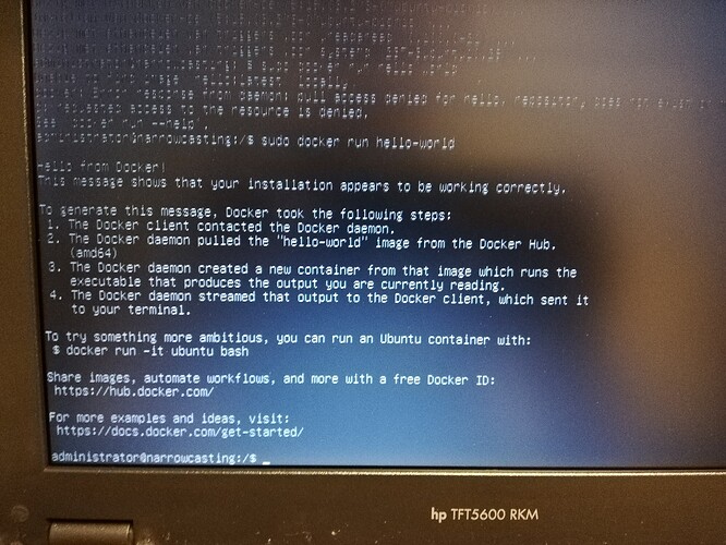

tnx for your help :slight_smile: but i get the following answer when i do run hello-world:
That’s the right answer !
Try again to launch Xibo Docker and tell me what’s happening.

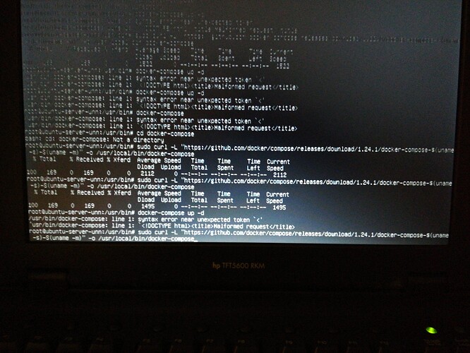

If i do that i get the following error:
That’s Weird.
I’m sorry but i can’t help more than this for now… Try too search this error message on google and you should find a soluce to this problem. I don’t think this is linked with Xibo.

You did not downloaded compose file, but html file. Redownload as @joshkacz instructed you
When i want to redownload docker-compose with the code @joshkacz give here all i get is the HTML file.
I think i do something wrong buy cant find out what it is
You started docker-compose from /usr/ bin. Probably this is also a faulty file from one of your previous attempts. Please delete this and any other first
sudo rm /usr/bin/docker-compose /usr/local/bin/docker-compose

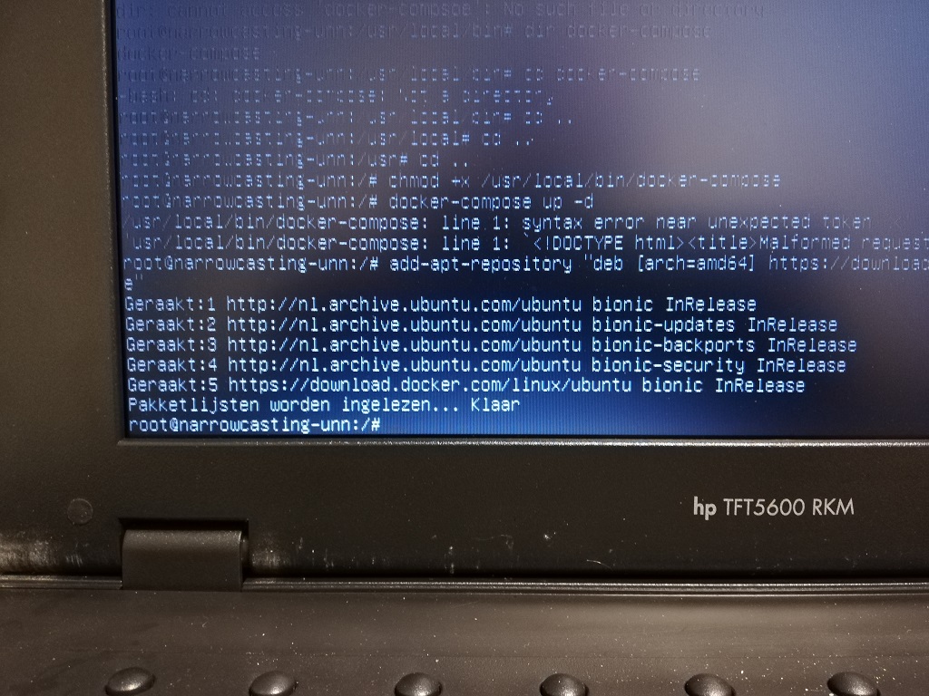

please provide the output of the add-apt-repository command
Here is the output of the command:
I just reinstalled the whole os Ubuntu server 18.04. I followed the guide to install xibo on docker but when i do docker-compose up -d it will trow the error i posted earlier.
