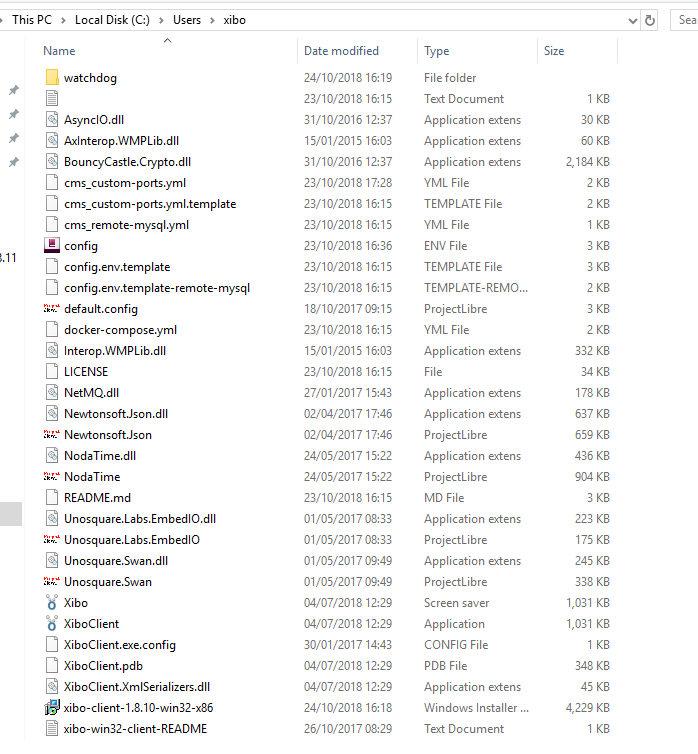

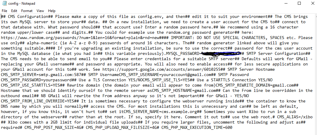

Here is an image of the directory
and above is an image of the config file
hope this helps, if you need anything else please ask
In the screenshot, there appears to be a number of different files for other applications in with your Xibo CMS files. I would recommend against setting up multiple applications in the Users/Xibo directory and keeping this directory clear for your CMS configuration files.
The issue may be related to Docker Toolbox not running correctly. You can reset Docker by opening VirtualBox and deleting the VM named Default. After you have done this, re-open Docker Toolbox to initiate a full reset.
After you have reset Docker Toolbox I would recommend preparing and attempting to up the containers again. If you receive any errors, please provide screenshots.

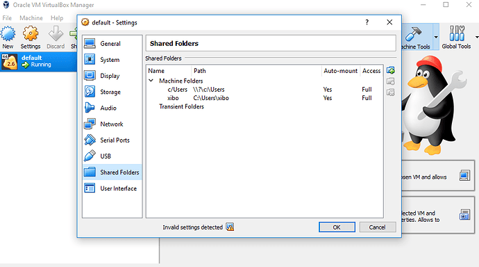

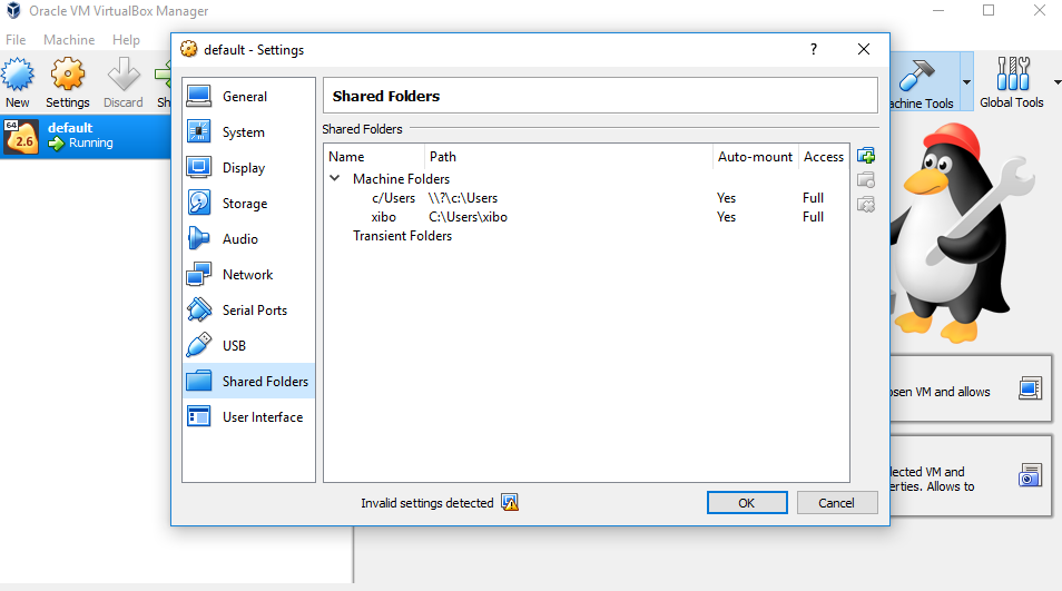

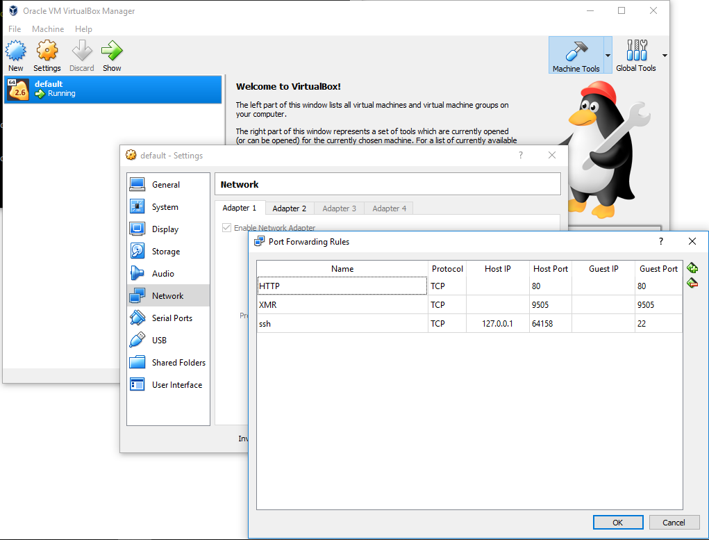

The above screenshot is my virtual box settings for network
The above is screenshot of virtual box shared folders
Any Ideas? Can I share anything else to help?

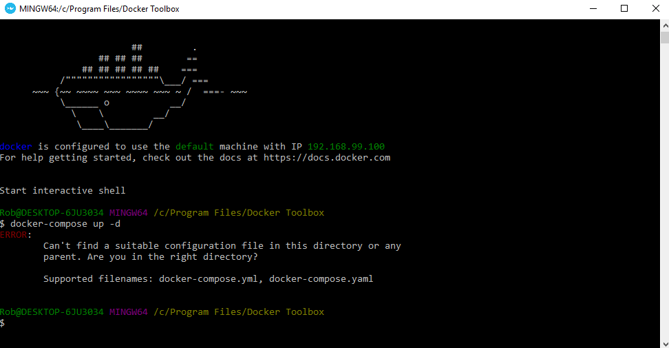

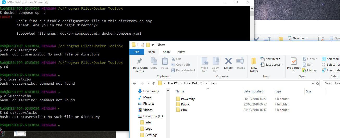

Can you provide a screenshot of the command terminal when you are entering the docker-compose up -d command? It would help to see the actual terminal and errors themselves if possible to make sure the command is being run from the correct directory.
Of course will upload now
Here is the screenshot after entering docker-compose up-d
The screenshot shows that you are running the docker-compose up -d command from the C:/Program Files/ Docker Toolbox directory, which is not where your yml files are.
You will need to first run the below command as one line:
cd c:\users\xibo
You will know it has successfully run as the directory will no longer state C:/Program Files/ Docker Toolbox in yellow as shown in your screenshot. It will instead state c:\users\xibo.
Once you have done this, run the docker-compose up -d command.
Hi Dan, tried this request however it is unable to find the directory… thanks for your continued help
Hi Dan, I tried spacing and using different case letters for the cd c:\users\xibo

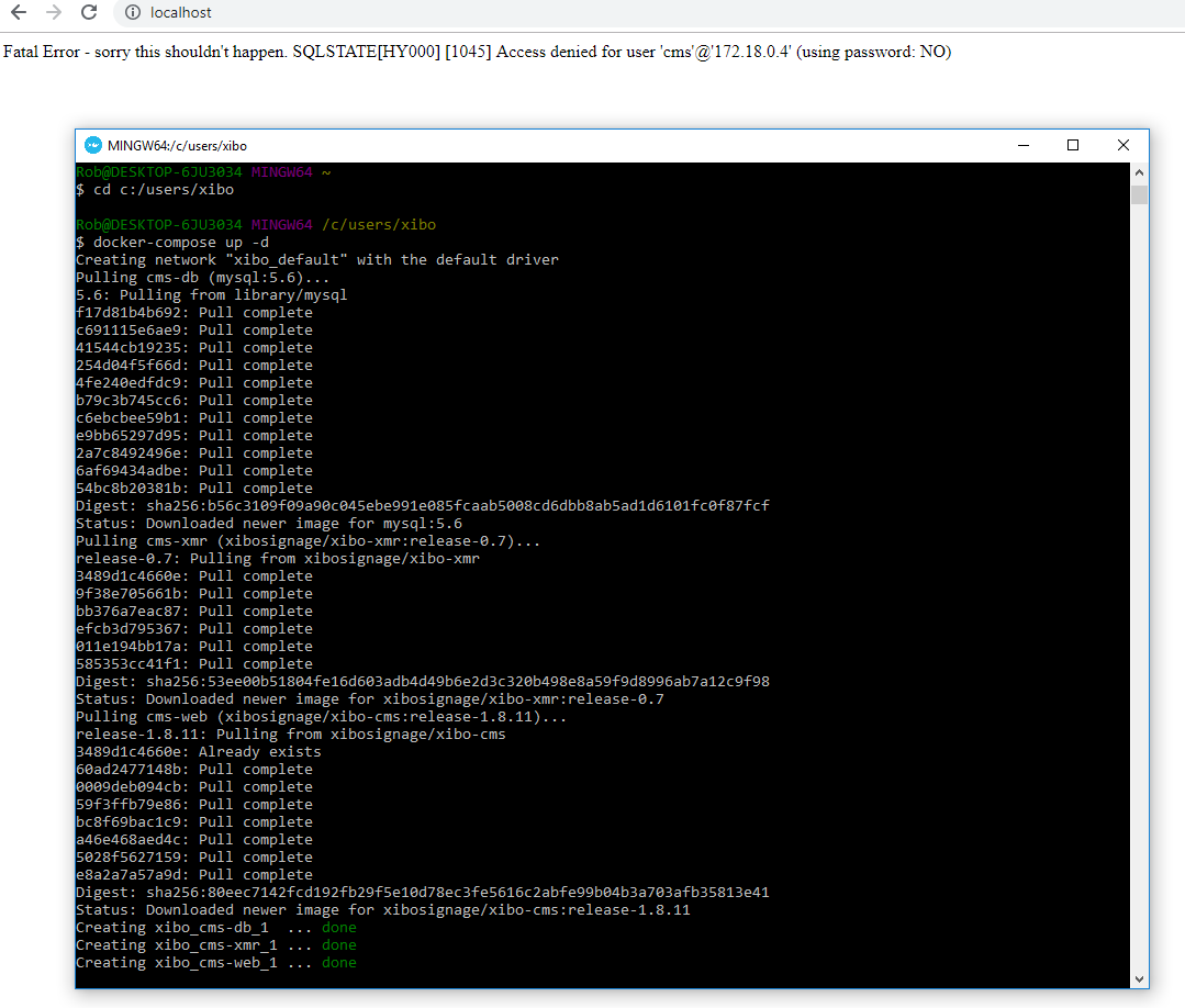

Then I ran docker-compose up -d and got the above screenshot, I then tried to search localhost on my pc and got a fatal error, any call on next move?
Thank you for the screenshots. According to your last screenshot, all 3 containers have been created, your CMS containers should be running.
You may find that when first setting up the CMS, it takes some time to become available. I would recommend giving the containers/CMS some time, perhaps 15 minutes to finish.

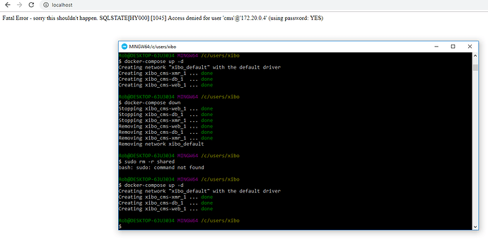

Hi Daniel,
Unfortunately still no luck for me here…
Please see above image
Note I did get a slightly different error message this time if that’s positive
Fatal Error - sorry this shouldn’t happen. SQLSTATE[HY000] [1045] Access denied for user ‘cms’@‘172.20.0.4’ (using password: YES)
Any Ideas?
I read previous support pages and tried Alex’s
docker-compose down
sudo rm -r shared
However the compose down and up comments worked but the sudo rm -r shared was unknown
There are 2 possible reasons why you are receiving this error.
Inside your config.env file, you will have set the MYSQL_PASSWORD. The rules for the password are mentioned in the comments at the top of the config file, stating that the password should only contain alphanumeric characters. If you have set a password that contains spaces or special characters in your MySQL password, you will need to change it to a valid password.
The error may also be generated if the Containers are created but config.env file was not fully configured. If the configuration of config.env is changed after the containers have been created and the docker-compose up -d command is run again. If this is the case, docker-compose down the containers, delete the contents of the shared/db folder and attempt the up command again.
If the above suggestions do not resolve the issue, please let me know if the error has changed. You can also send me a copy of your config.env file in a private message so I can take a look.
