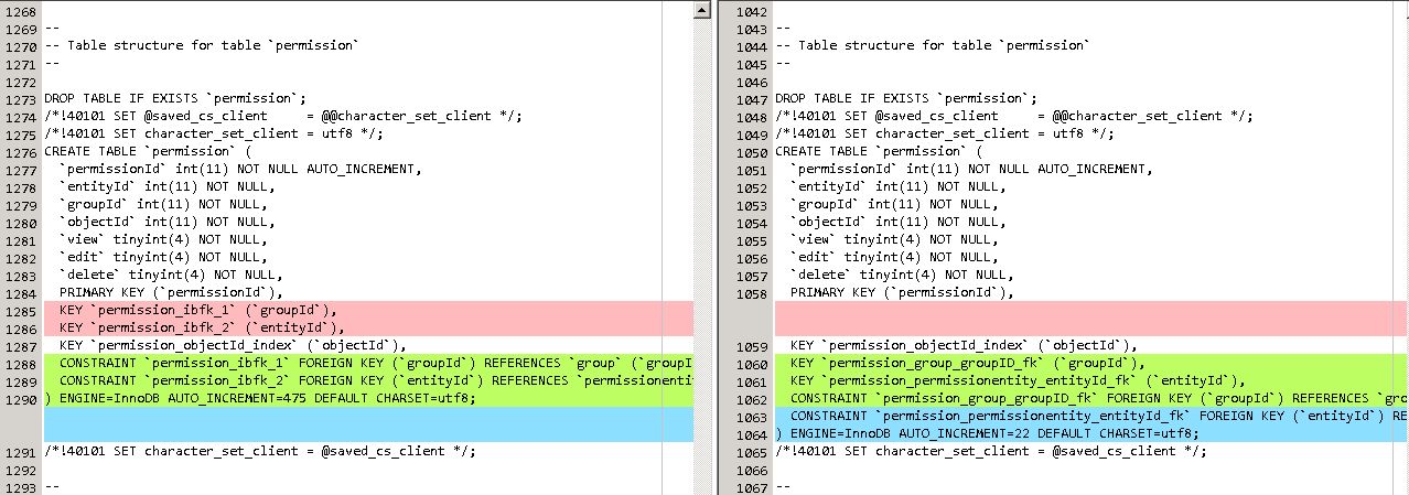

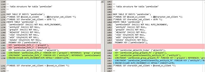

Here is a database comparison between a new installation of 1.8.11 (right side) and an update installation (left side).
The following update steps were carried out:
Xibo-cms-1.8.1
Xibo-cms-1.8.2
Xibo-cms-1.8.7
Xibo-cms-1.8.9
Xibo-cms-1.8.10
Xibo-cms-1.8.11
I’ve checked a database here that was upgraded to each point release in 1.8 and those keys are correctly defined there.
It looks to me as if a step was skipped in the 1.8.10 - 1.8.11 upgrade where those would be added. If you still have your backup, I would suggest rolling back to 1.8.10 and performing the upgrade again, ensuring that no steps are skipped over.
Failing that, you could add those keys manually.
I have the error in all update installations and I have not seen any errors during the update.
All custom installations !

Another example of update order:
Xibo-cms-1.8.1
Xibo-cms-1.8.2
Xibo-cms-1.8.3
Xibo-cms-1.8.4
Xibo-cms-1.8.5
Xibo-cms-1.8.9
Xibo-cms-1.8.10
Xibo-cms-1.8.11
The code that adds it is here:
That’s definitely run in the 1.8.10-11 upgrade steps.
If you can send me over your database prior to upgrade I’m happy to try an upgrade here and see if they’re added correctly.
I just installed cms 1.8.10 and immediately afterwards installed the update to 1.8.11.
Database was still empty.
There were no mistakes.

The two keys are correctly listed there?
I’m missing the issue in that case I’m afraid.
416b0aac9c3308a987379d04e3be93c3702d0484_1_690x242
The table structure is different, or I am wrong. ?
