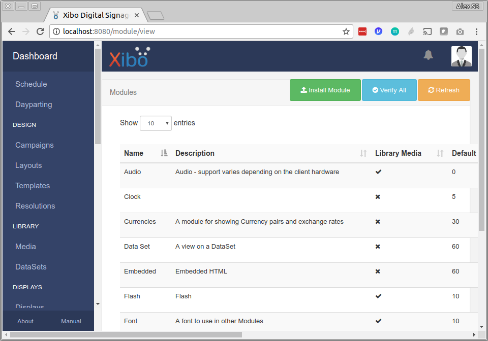

When you click in Modules page for example, the page load correctly?
I have the proxy listening on port 8080 and the CMS container on 80.

I don’t think that should be any different. I’m only testing with another container as it’s convenient to do so.
It would be worth seeing what URLs are being called from Chrome Developer tools too as that might offer an insight.

That’s exactly the config I’m using.
As a side note, you’d probably also want in there a client_max_body_size 2G; line to match the upload size you’ve set in Apache.
