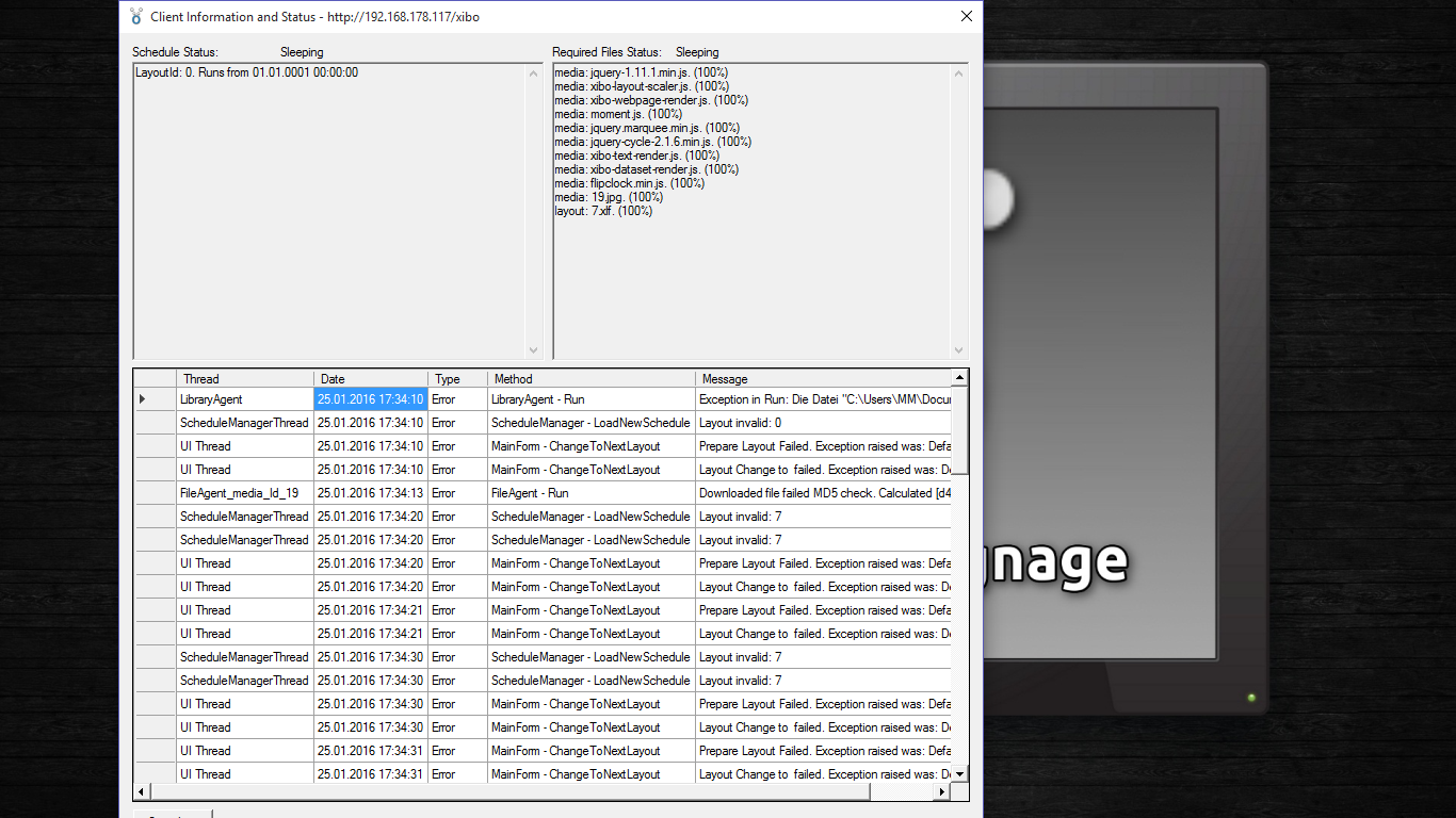

Hi, I have now decided to install the Xibo server on a Synology and the client on a Windows computer. The server I could install without problems, the client I do not know how I define nicaber the Library path in the settings. I would like the library on the local machine put on drive E. How would then the Library path look like? E: \ or /…/ ?? Please help me. Because if I einplane a layout then takes on the client just the start screen with the Xibo symbol and remains there even are.
Tis is my .xml:

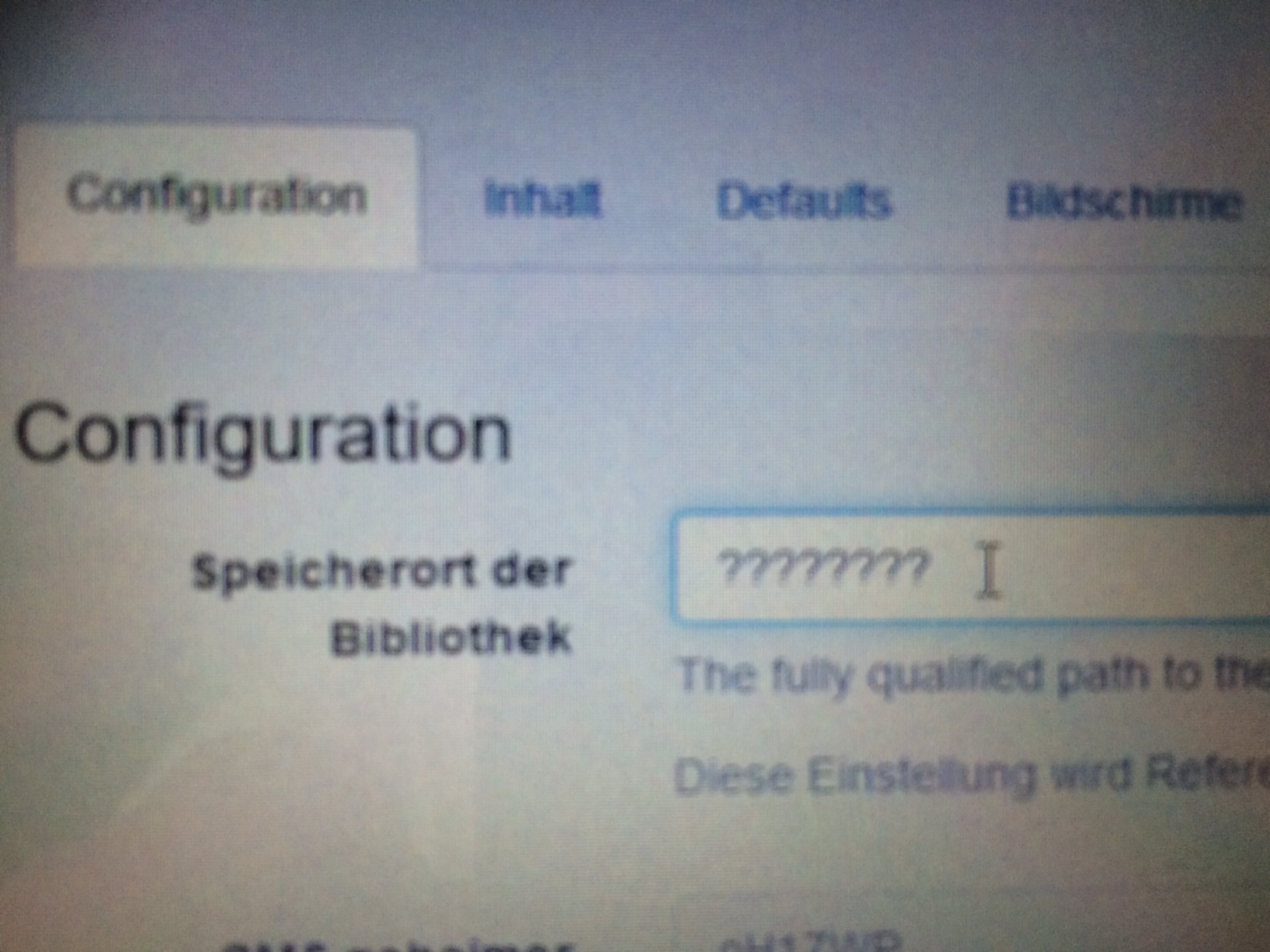

But what must i stated in the webinterface from the synology. Look at the picture please and say me what path i must stated?
Very thanks
markus
I can’t tell you what to put because I don’t know where you originally configured it to be, or where the storage space is located on your Synology box.
All I can tell you is you configured it during the installation, so it’ll need to be set to wherever you chose during the installation.
If that location isn’t suitable, then you need to manually move the existing server library folder to wherever you do want to put it, and then update that setting to reflect it’s new location.

but can you say me what this picture obove say?
Greets
