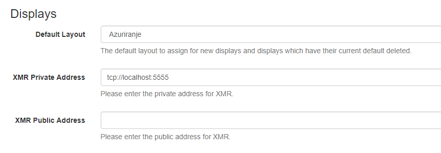

In any case, what do you currently have in config.json regarding xmr public/private address and what do you have in CMS settings -> displays tab regarding the same?
Here is what I have in CMS settings…

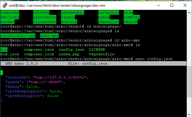

On server in config.json…
Right, so you don’t have public address at all in CMS settings and private address is on a different port between config.json and CMS.
That can’t possible work in the state it’s in at the moment.
Please see http://xibo.org.uk/manual/en/install_xmr.html
listenOn (private xmr address) is for CMS, so that can be on localhost - but the ports needs to be the same in config.json and CMS settings
pubOn (public xmr address) is for the player, so that’s most likely should not be localhost, but the CMS IP/domain it may very well run on 9505 port, but again the same information need to be in both config.json and CMS settings.
