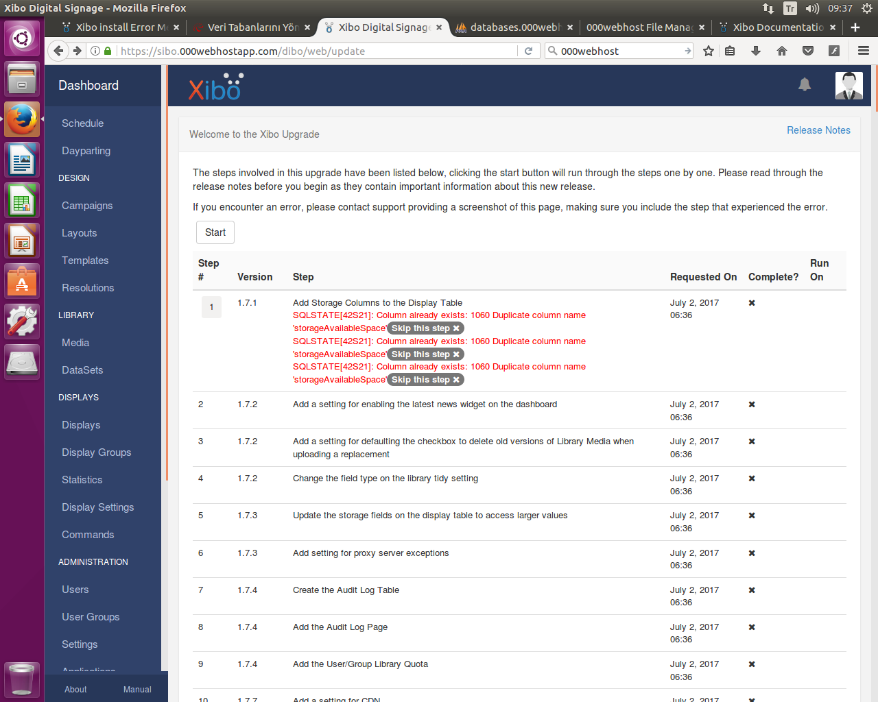

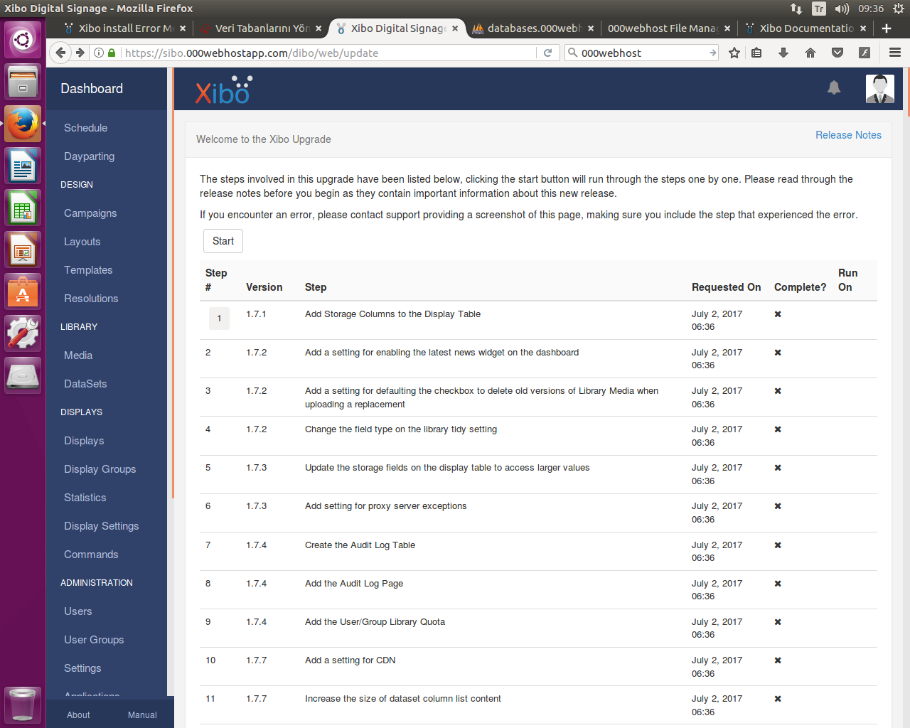

I did not receive any error messages during installation. After entering the username and password on the XIBO login screen, I get the error screen that I sent to the attachment. I do not watch this screen because I do not press the start button. I can’t skip this screen.

You are running the setup for a fresh install, but the database isn’t empty.
You need to clear out the database of all tables (assuming you want a new install, and that the tables in that database don’t belong to some other system. In that case, Xibo can’t share, so you’ll need a new clean database for Xibo), and then run the installer again.
