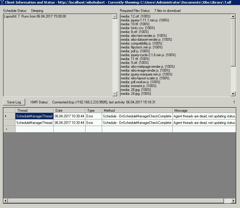

Xibo 1.8.0 - Infoscreen shows "files to download" for a long time
After adding an event to a screen (XMR running) the Infoscreen shows “files to download” for a long time even though the player already plays the media.
Collect interval: 1 hour

Info Screen: 7 files to download

Now it’s gone.
It seems as if it went away after 1 hour.
Collect interval: is 1 hour
It’s rather strange, on player window it should be updated as it downloads new files, I’d be less surprised if in the CMS -> manage would show some files as not yet downloaded.

Problem seems solved. It only happens when client and CMS are on the same computer.
interesting, I actually did my test with that configuration, although in docker environment.
Both Client and CMS on Windows Server 2008. There also the screenshots do not work.
