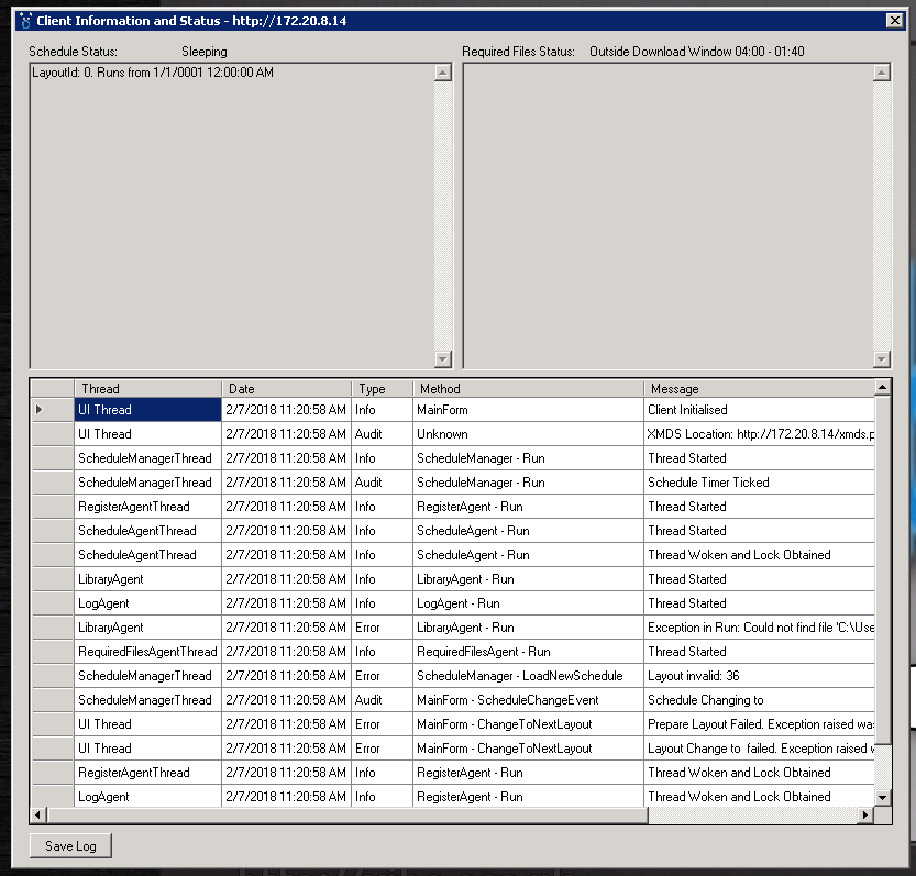

Can we see a screenshot of the status window on the player where it does not work please?

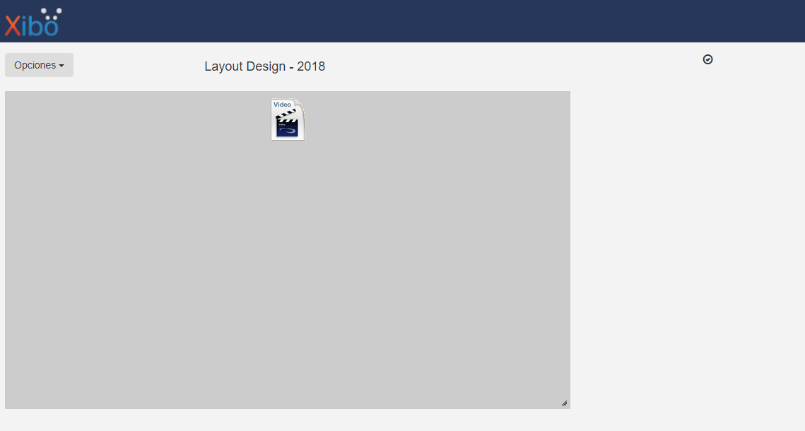

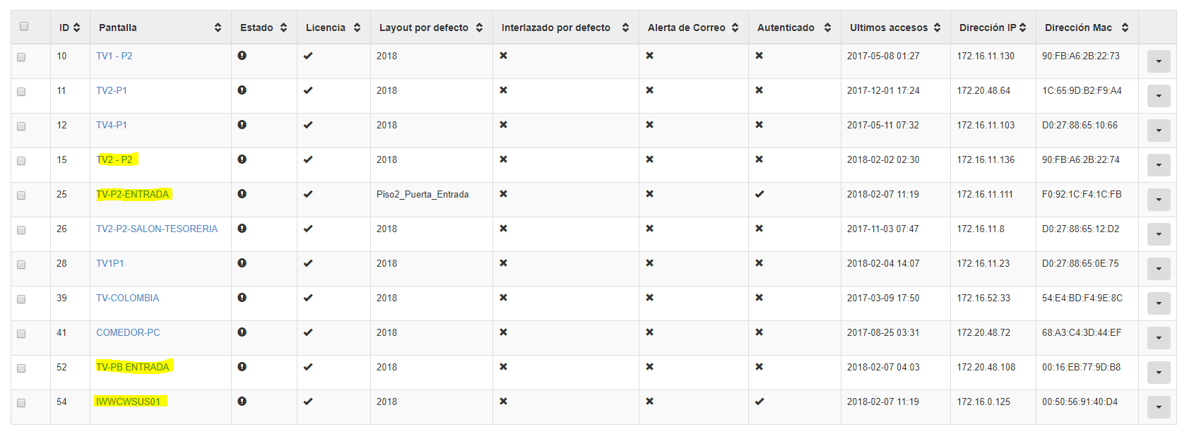

Yes, the layout is set as default. And according to CMS it’s valid.
Here’s screenshot of info window and CMS.
The thing is that a new display syncs that layout with no problem the first time after installation, changing the layout or uploading a new file into the default one make it stop syncing.
Here are the displays, the ones highlighted are the ones that are currently in use, the other ones are in different bulldings or are off.
If you look at the required files status on the player status window, that does not seem fine does it?
Please navigate to the Display Settings page -> Edit display profile assigned to your player
adjust the download start/end window
Preferably to the default values ie 00:00 and 00:00 which means always open, save the profile, restart the device.
