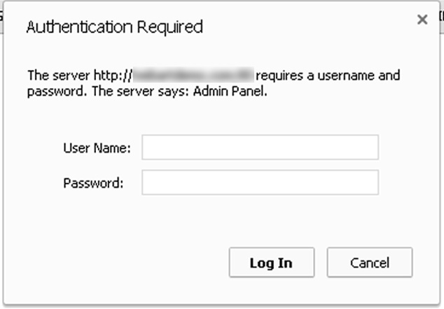

You will need to take a look at your setup and confirm that basic authorisation is being used. If the login looks like the below image, then it is using basic authorisation and so the issue may be related to how it has been set up:
If you are using a login page on your website, this would suggest you are not using basic authentication and so it will not work.
