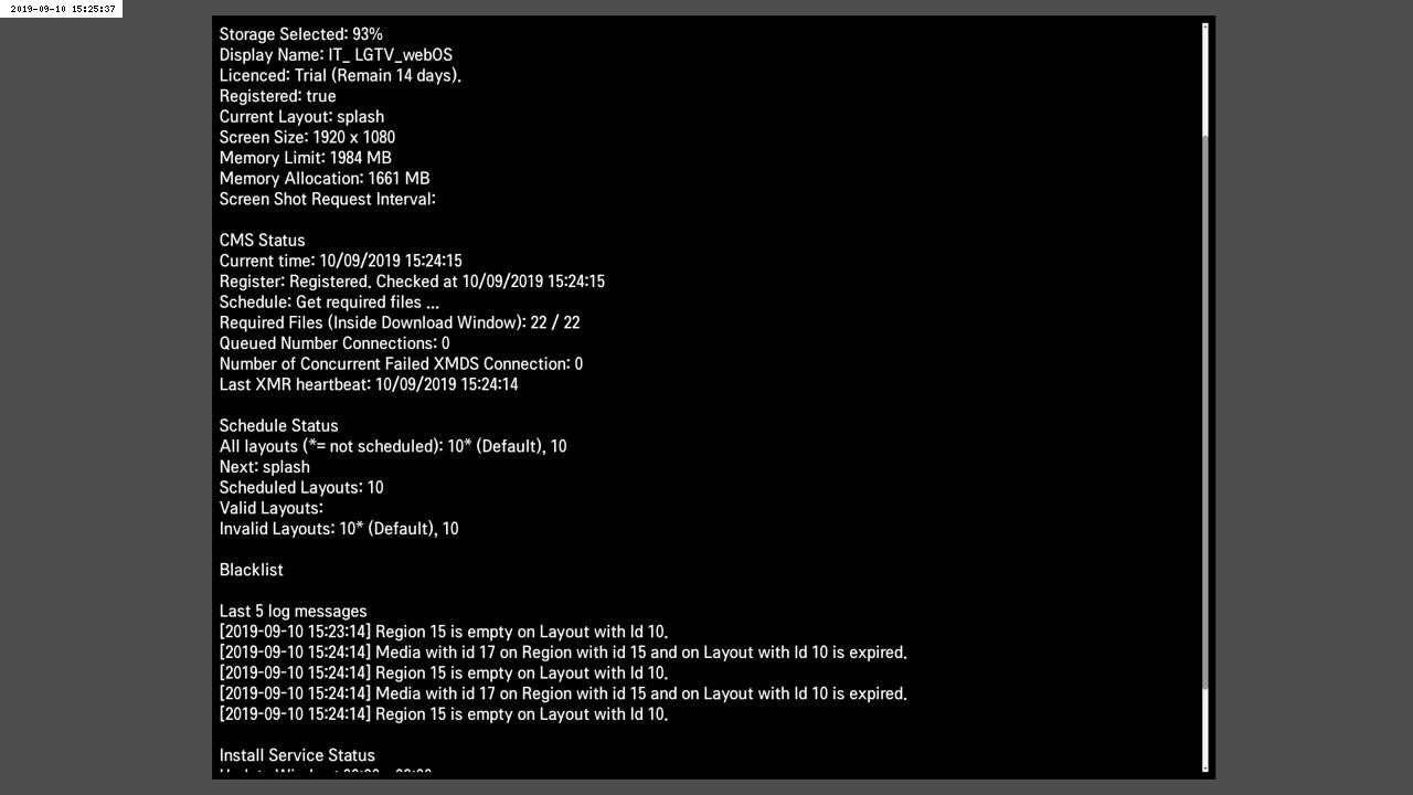

I am unable to play anything on the player:
-I’m either getting that the regions are empty. Non existing regions…Either that the media expired… fonts in this case
-I’m not even able to display the default template.
Attached a screenshot, hope you might be able to share some light. I’m really close to downgrade to 1.8 and have everything working again

Could you export a Layout so that we can take a closer look at this for you?
Could you also post screenshots of the Region in Layout ID 10 that has media ID 17 in it, showing what expiry dates are currently set.

For the sake of this post I installed everything from scratch again with CMS 210 and connected the player. No alteration was made to the default template:

So that we can troubleshoot this we would need to see the layout or at least a layout that triggers this, could you set up a demo CMS with the same set up so that we can look at it?
Alternatively could you describe your exact set up in an effort we could replicate this issue?
The issue looks to be in expiry dates of the widgets, which is why 1.8 works as that earlier version does not have that feature.

I managed to have a working 2.1 with a 1.8 webOS player.
I will have to pay attention if my TV actually is compatible with the latest player but for now is more than suffice.
Thank you for your time
Please do update your firmware version as the one currently showing in your screenshot was the initial release version. Use the recommended version for the model you are using: Firmware Matrix
