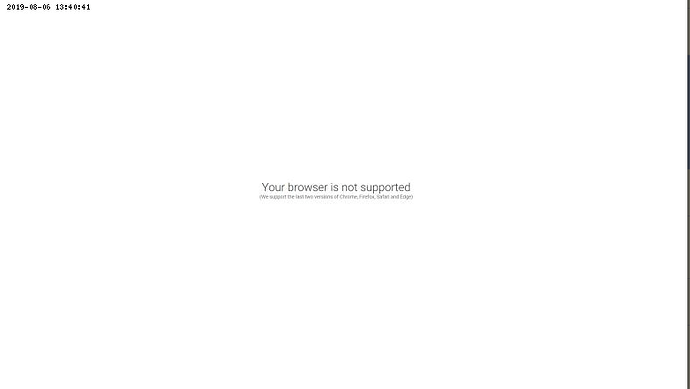

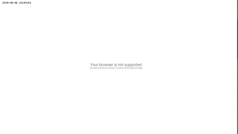

I then decided to create a simple Layout using the URL in your Iframe and this is what appeared on my Display before the screen turned black:
It appears that the website you wish to use with your Player is not supported on the browser used with the player. The Xibo for Windows Player uses Internet Explorer, which is not a browser that the page lists as supported. My apologies for any inconvenience.
