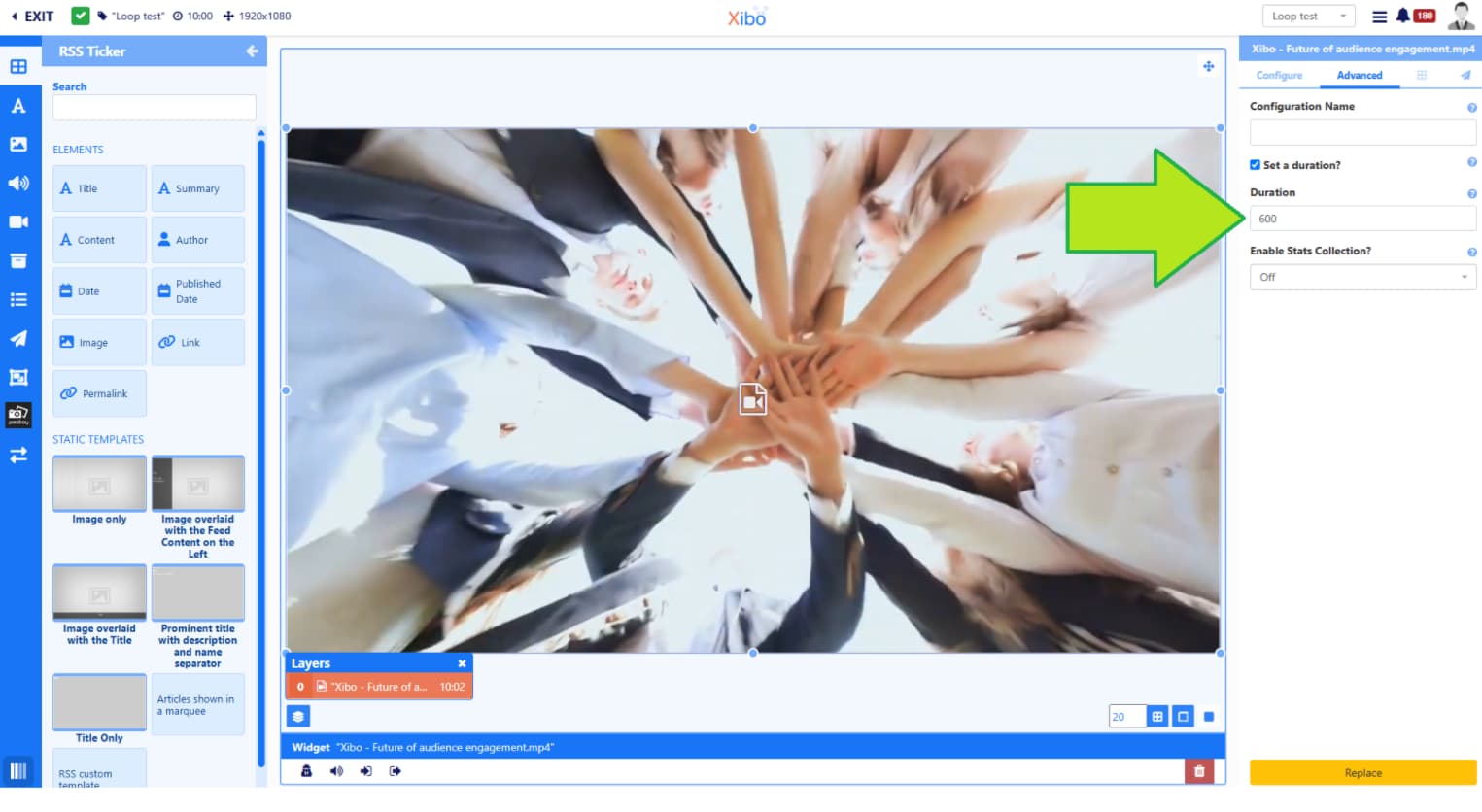

There is in fact a loop button that appears after you set the duration for the video to be higher than its standard duration.
For example, you can see that I have set this video to a duration of 600 seconds:

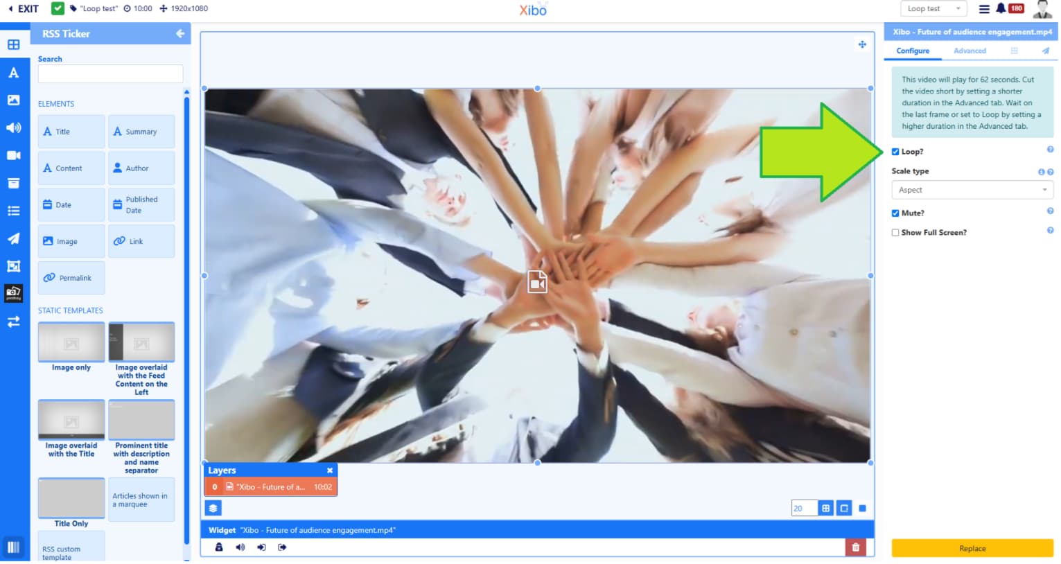

After I do that, the loop button appears on the configure tab for the video:
Oh wow and look at that, it works. Thanks a lot!
