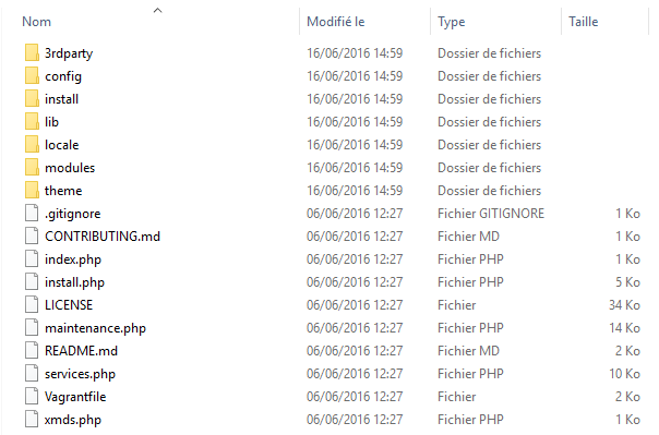

When you talk about API, you talk about CMS, so it is this folders, isn’t it ?
And I know, it is not hard but the employer prefer that the employees do not touch to Xibo.
So how can I do my own application ? Could you help me ?
That’s the CMS install - a 1.7 installation at a guess.
To use the API, you’d need to move up to the 1.8 beta.
I can’t help you write an application. The API is fully documented and we provide example code for connecting to it.
