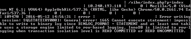

Okay I have now run the truncate command but that didn’t change anything. After looking at the log table here is error we found when I try to login.
I checked my log file and this is the same error that I get when I try to log in.
Error writing session: SQLSTATE[HY000]: General error: 1665 Cannot execute statement: impossible to write to binary log since BINLOG_FORMAT = STATEMENT and at least one table uses a storage engine limited to row-based logging. InnoDB is limited to row-logging when transaction isolation level is READ COMMITTED or READ UNCOMMITTED

In 1.7.7 we change the transaction isolation level to READ COMMITTED to support running on systems where there is MySQL replication going on. Unfortunately that’s incompatible with setting up MySQL to BINLOG_FORMAT = STATEMENT.
You can change that setting to MIXED in your MySQL configuration and restart MySQL to get things working if it’s appropriate in your environment. If you’re not using a replicated MySQL instance then as far as I’m aware there’s no implication for making that change.
I’ve logged it as a bug to be investigated here:
Thanks. I made the change in MySQL and we are able to log into xibo.
