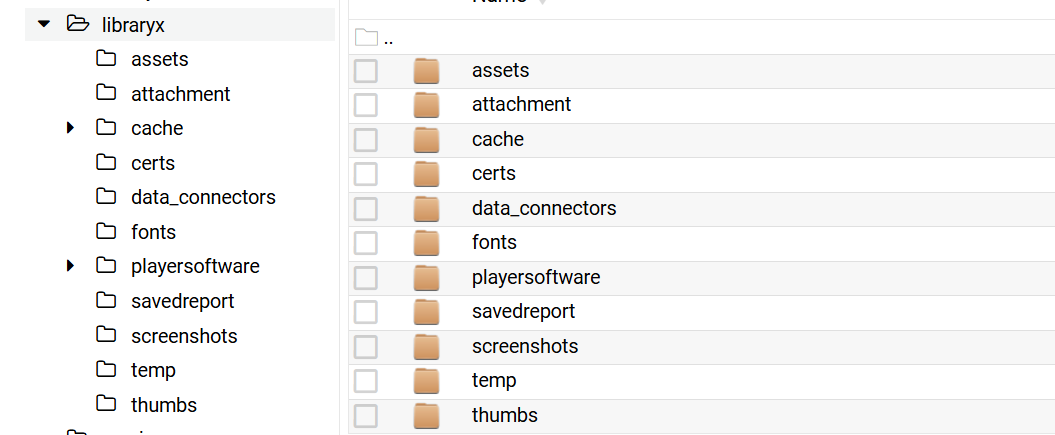

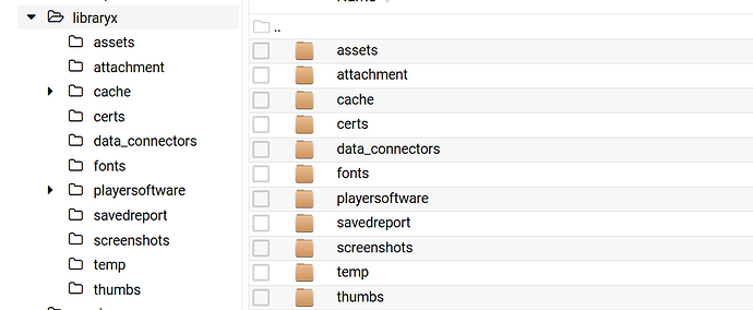

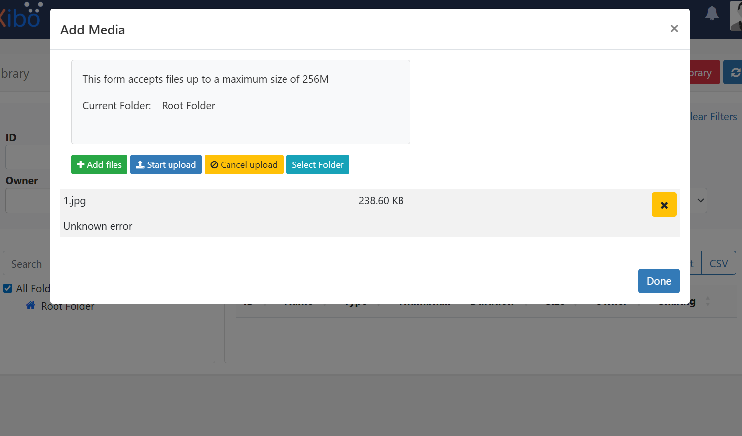

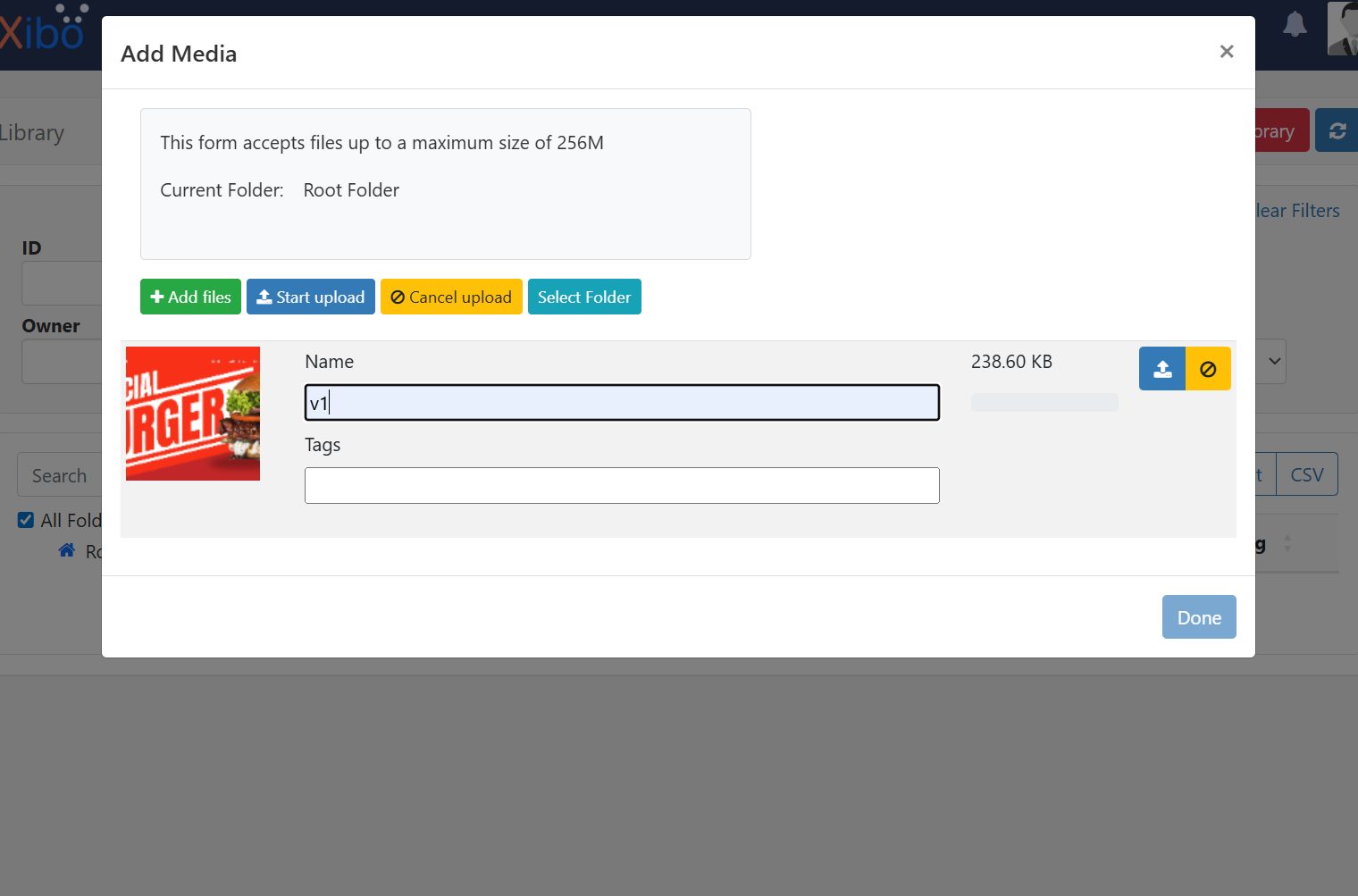

Cant seems to upload media files onto the library folder. Originally thought it was the permission, so changed a new library folder and its the same problem.
Keep getting unknown error.
Below are the screenshots of the problem.

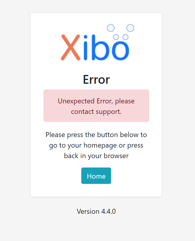

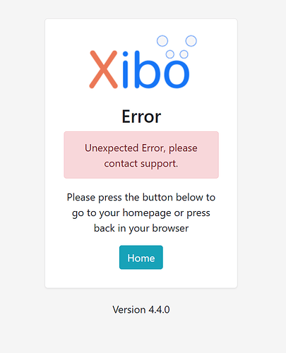

Once i changed the ownership,…. it became unexpected error… Weird…
Sorry adding on. i am using webmin to manage my server with virtualmin as my “cpanel" control. so the ownership its under the virtualmin user. i change it back to the original user and it can login … but kept having the unknown error.

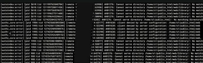

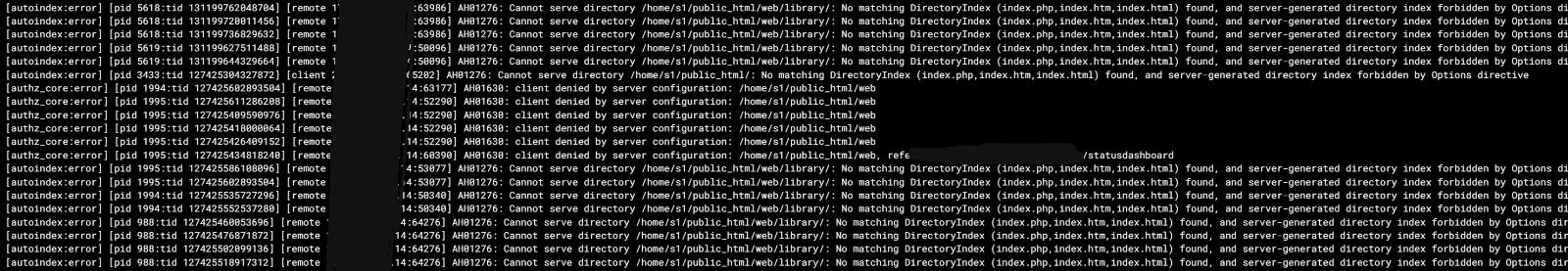

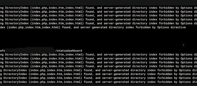

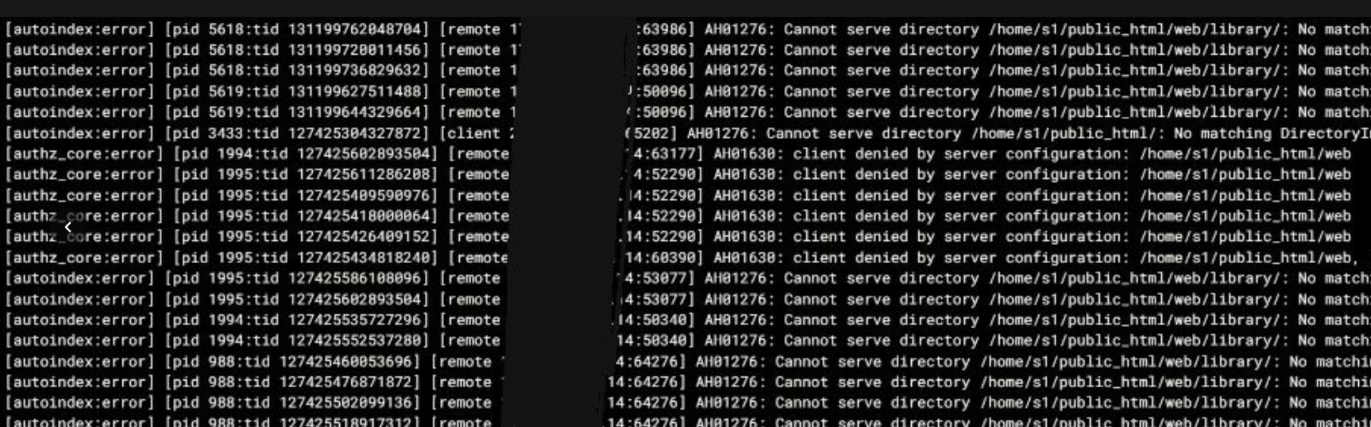

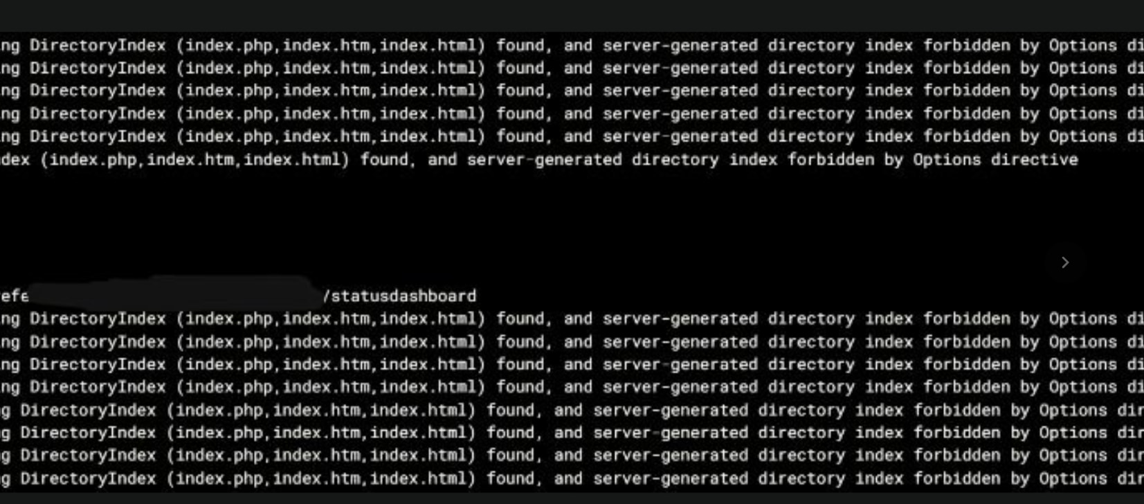

Wat does the Apache and PHP logfiles say?
the php log didnt show errors, the error of max post size was fixed earlier.
but the apache log as below.

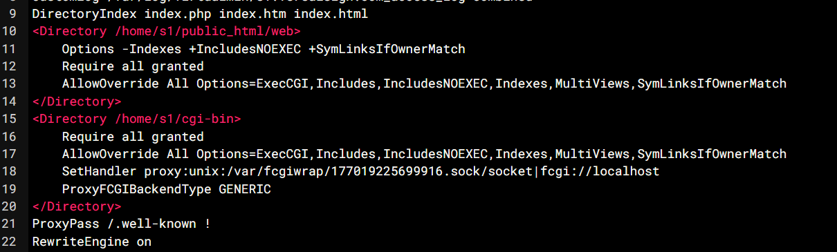

and the apache directive
Require all granted…
is there something else that i am missing?
