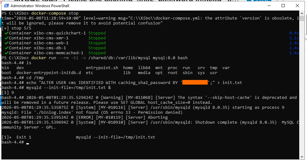

I’m getting a Permission denied error:
"mysqld: File ‘/binlog.index’ not found (OS errno 13 - Permission denied)
see screen shot

You need to adjust the path in your docker run command as you’re on Windows (which we don’t support/recommend).
I presume it would just be docker run --rm -ti -v C:\Xibo\shared\db:/var/lib/mysql mysql:8.0 bash
but I’ve no way to test that here to confirm. I do know that Docker on windows is case sensitive, so if the Xibo directory has a capital X it’s important you use a capital X in Xibo in your command.

Thanks, worked fine
