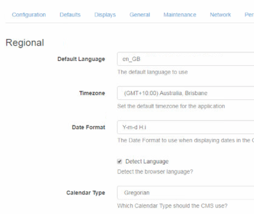

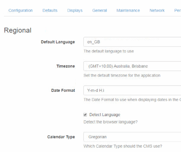

The CMS Timezone is set to Australia/Brisbane GMT+10
The Windows Host is set to Australia/Brisbane GMT+10

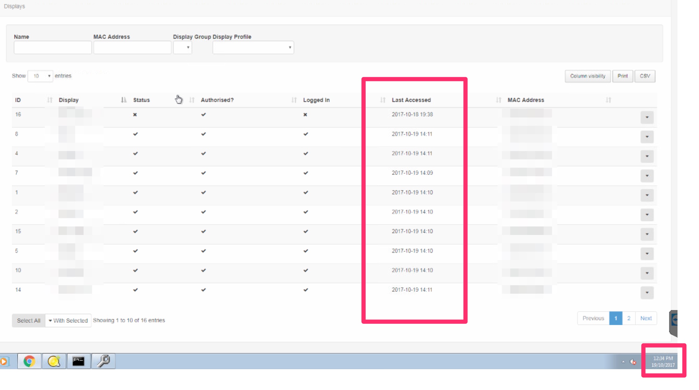

However, the CMS is showing a different time under Displays (see screenshot below).
In addition to this, the players are showing this same incorrect time in their Clock / Ticker Modules.
The time difference is also strange as it’s not a whole hour.
Sorry, I should have clarified - all the players at this location have a 1min collection interval set, so they shouldn’t ever be more than a minute or two out from the current time.

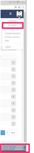

I’ve checked the current time as you asked by clicking the Avatar icon and it does appear there is an issue.
Any idea why you think this might be the case?
See images below. CMS thinks it is 21:09pm when the current time is actually 19:31pm (at time of screenshot).
I’ll do some googling, but it’s been operating perfectly for close to a year now, and I only just recently (as of the 1.8.2 upgrade) that it’s happened.
As Bitnami WAMP is just a packaged version of PHP, apache and mysql, it shoudn’t have changed.
I wouldn’t have thought Timezone would account for the ~50mins difference in time either.
I’m sorry, I’ve just found the issue and can confirm it’s not Xibo related and I’ve wasted your time.
Long story short, this Xibo is running on a virtual server with other Windows instances.
The Windows instance I was logged into was not the correct one. Once I logged into the correct Windows instance it became clear the issue was in fact incorrect System Time as it hadn’t syncronised to a timeserver in a long time.
