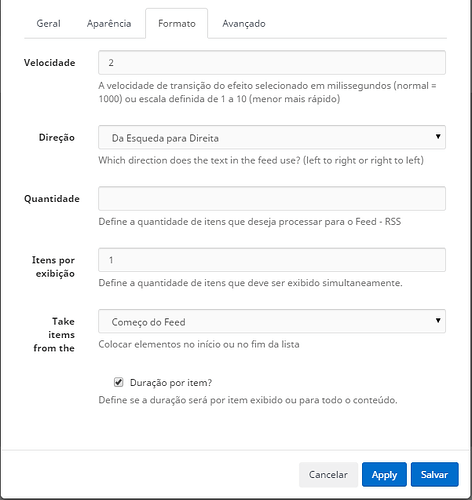

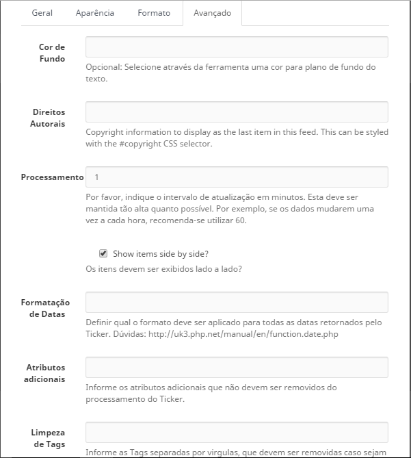

I am not sure why you have ‘Show items side by side’ when you also want to display only 1 item per page, but that shouldn’t cause problems.
1 min update interval might a bit of a overkill(and actually might cause some problems), does horoscopes change that often?

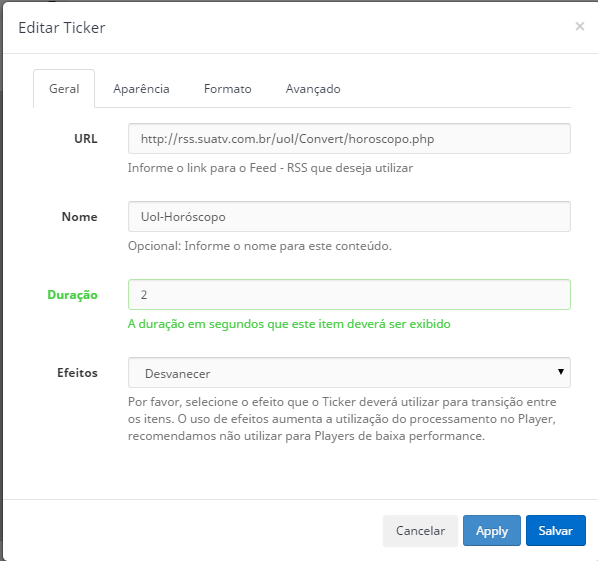

We can not include a clock lasting 300s. Let each ticker item for 6 seconds on the screen. Putting the clock as his guidance we would have the ticker in repetition.
