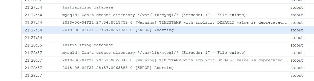

i tried to install xibo in docker! when i start mysql (5.7.22) then everytime i get the message: Docker-Container: cms-db stopped. if i open the protocol it shows the following picture:
Can someone help me?
I’ve tried the routine several times but it is always the same problem!?
Thanks for any replies.
The error shows that it could not create the database because it already exist. I hate to say it, but you need to wipe out the containers and start again. I know, that isn’t fun, but that should fix your issue
NOTE: If at any point you make a configuration error or want to make a change to either the cms-web or cms-db containers, it is best to delete the containers and start new. (Unless you have previous data. Always backup before anything) Also make sure to remove all files from the database folder before creating a new cms-db container, or you will need to start again.

try to find out the error:
starting putty via ssh conect to synology. and i found out, there is adirectory /var and the next /var/lib too, but there ist no directory /var/lib/mysql
i don’t understand my error!
can someone help me?
thanks
michael
here is what the protocol says:
Initializing database
mysqld: Can’t create directory ‘/var/lib/mysql/’ (Errcode: 17 - File exists)
2018-06-11T20:46:14.788278Z 0 [Warning] TIMESTAMP with implicit DEFAULT value is deprecated. Please use --explicit_defaults_for_timestamp server option (see documentation for more details).
2018-06-11T20:46:14.792952Z 0 [ERROR] Aborting
Milo_r,
Sorry I was on a short vacation.
Looks like you traced the problem back to missing the “mysql” folder, and it not being generated.
In the Docker control panel, on the cms-db container, when you go to volume, does it look like this?
Possible reasons you are missing the “mysql” folder is the “Mount Path” was not set correctly, or that the username and password for SQL have not been setup. I came from an existing database, so I did not need to configure the database Administrator username and password. This article might be helpful.
I think though the SQL Container on the first run sets the all the connection information that it has been supplied with. You did set the “MYSQL_ROOT_PASSWORD”, “MYSQL_PASSWORD”, “MYSQL_DATABASE”, and “MYSQL_USER” before allowing the container to start? If not, then try setting those and see if a folder and database are created then.
