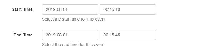

I have learnt something new about this, it would seem that you can already create Events that are shorter than 1 minute in length. First go to the Settings option in your CMS and choose the Regional tab. Make sure the date Format includes H:i:s to allow seconds. now you should find that you can create an Event with From and To dates that allow you to not only schedule to the second but therefore create Events that are seconds in duration as opposed to minutes@
The above example would therefore start the Event 15 seconds after 00:15 and end at 45 seconds after 00:15, an Event 30 seconds in length.
I hope all of the above information is helpful.
To clarify, adding a : after the minutes will allow you to specify the seconds, which you can then of course use to create an event shorter than one minute.
I hope this is helpful information
