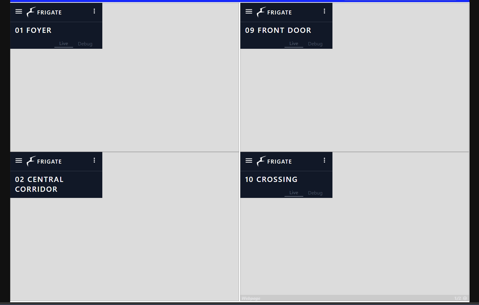

we upgraded our CMS yesterday to 3.3.5 and have also upgraded our players to 3.308.0, however, we have some really strange layout issues now.
for example, this particular layout is used to display four IP CCTV Cameras, now it just shows parts of it.
Which should load another internal page. but doesn’t seem to be loading correctly either.
This is also set to manual with only:
Offset top: 5
Scale 78.
Setting these pages to “native”, or “best fit” do not resolve the issue, nor does rolling the client version back to 3.301
We are using windows client, but the layouts now look the same in the CMS. - They looked like they should previously.

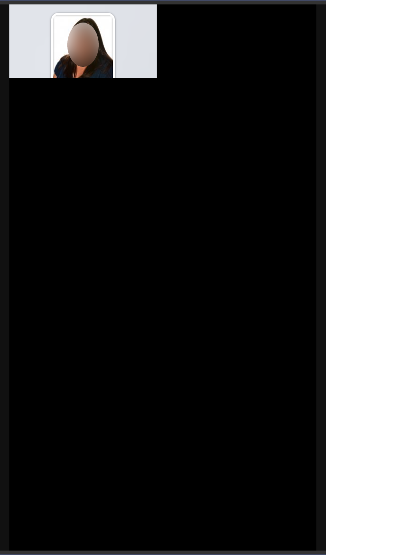

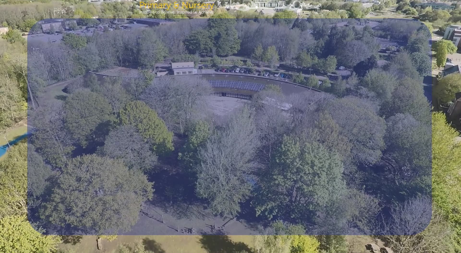

I’ve also noticed that two other layouts: the first a video with an overlayed semi-transparent box, and then ontop of that text isn’t loading correctly either.
and the other is a display
contains the same CCTV elements as the first layout i’m having an issue with as well as a clock and out Helpdesk. The helpdesk is loading ok, but nothing else is.
