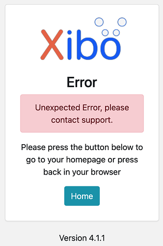

first time for a few years using Xibo and whilst the docker install process was easy to follow and worked perfectly im now facing an issue which I can’t resolve and seems Xibo doesn’t want to know either…
this is a self hosted out the box on a dell R330 server with 3TB disk space and 64GB ram, installed perfectly and I was able to login and get my way around the CMS, ive since moved the server to its permanent home on a commercial site, I have SSH access and I can find the Xibo server on the IP which ive static set on the router using a MAC reservation…

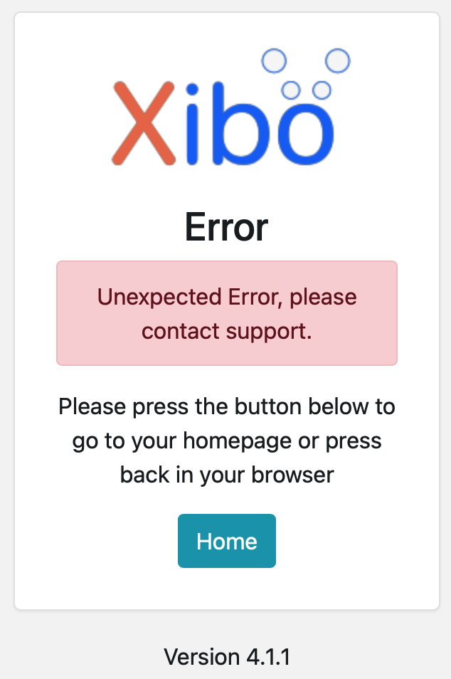

when I try to login using xibo_admin and my password I get an error which says the following
un expected error, please contact support
does any one know what might be wrong with this instance as it worked fine before I powered down and moved the server…
