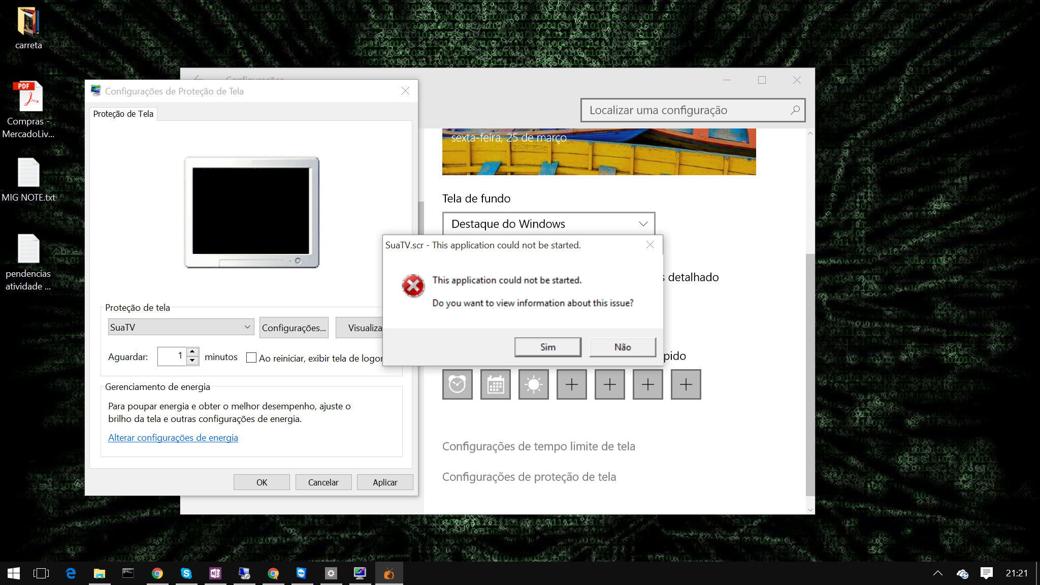

I copied the SRC file to the System32 directory WIndows
In the screensaver setting the option to select, but when you select appears the error screen.

This is the problem , you select the screensaver It appears the error to printscreen .
I can not click settings, I can not click preview. Only the error screen …

I was facing the same issue and find out that problem was Autocad. Coincidently Autocad scripts use .scr as extension and it changes the default application. Then I´ve restored scr to default and installed the Xibo.scr as per documentation (instead of copying it to system32 folder) and it worked.
I deassociated the scr file extension with AutoCad by going to my registry editor > HKEY_CLASSES_ROOT > .scr and changing its Data from ‘AutoCadFile’ to ‘scrfile’.
