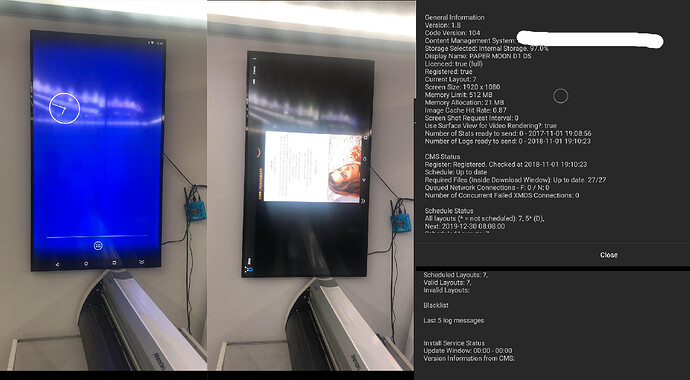

I am using Xibo 1.8 with DSCS9 Android devices with android 6. The problem is I have created a portrait layout here in the web and rotate the screen to portrait as well. But when xibo starts it becomes into landscape mode.
Any help on this? Please!

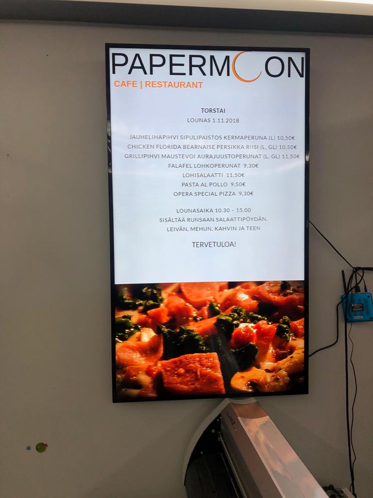

*Changing the Display Profile Settings for the Android Profile I am using with the DSCS9. Under the Location Tab, I set the Orientation to Portrait. < & thats what i was missing … and its working now :smiley:
That’s great, glad your Display is now configured to Portrait fully.
