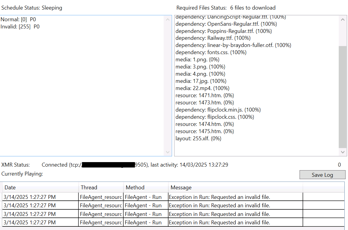

When I publish changes, only one display updates successfully in player,
while the other gets stuck on the Xibo logo.

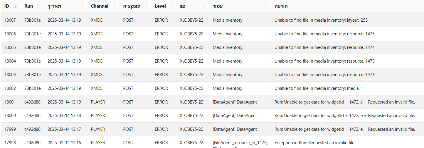

I checked the log, and the error message is: “Exception in Run: Requested an invalid file.”
Why does only one display update successfully?

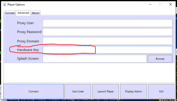

Hi Ran, can you stop all xibo process client on your display ? suppress all folders in My Documents, Redo the integration With xibo client option (just put the correct hardware key ( the name of the display you will find it in the CMS)
Connect you should see conected
Launch player wait few linutes, the data will reload on the player
I did it and still one display not updates after publish.
I keep getting the error Exception in Run: Requested an invalid file
If I use 2 layouts, one for each display all good.
(I push each layout and it updates on both displays)
only if I use 1 common layout for 2 displays I get the above error after publish,
but only on one display…
