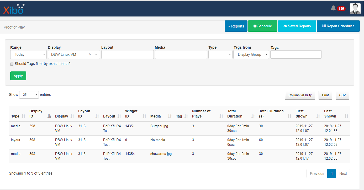

I made sure to use images for this test that I’ve never used before to ensure the test is fair. After waiting for the layout to run a few times and return the stats, I now check the Proof of Play Report option to see what has been recorded:
I can now see the Proof of Play statistics for that particular Layout and the images I added to it. I would recommend checking that all of the above steps have been followed, if you still encounter an issue I would recommend upgrading your CMS as I can confirm it is working on 2.1.2.
