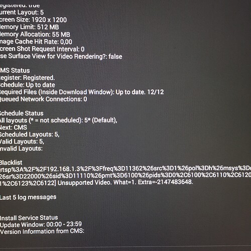

Error with the standard settings on all devices:
Blacklist
[rtsp%3A%2F%2F192.168.1.3%2Ffreq…] Unsupported Video. What=1. Extra 2147483648
Error with the “use public storage” option activated on all devices
Methode: StorageOptions. Message: Removing point that doesn’t exist: /mnt/media_rw/sdcard1

So basically all your devices are giving, canRun errors, unsupported video (encoding), then they are blacklisted and whole layout is invalid.

If you have CMS 1.7.6 and now R59 (or even better the one that I sent you via pm)
You could try changing the rendering method to TextureView and see if that will make any difference.
In CMS 1.7.6, please go to display settings -> edit display profile assigned to your device -> troubleshooting tab -> untick “use surface view…”
You could also try to switch to Public storage (In Xibo app settings -> Use public storage? and first option in storage options) and see if that will change anything
