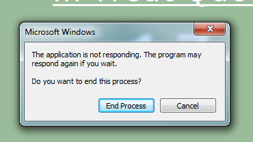

Nevermind… it’s not Xibo. If I leave the pages running long enough in IE11 it’ll freeze up and start throwing errors (even though I don’t get any error messages in the console). Seems to be an IE bug. Not sure if a bad update was pushed recently but it’s killing everything. No issues like this in Chrome or Firefox.

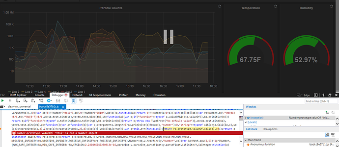

It’s plausible that it could be IE issue then, although there should be something in the console/network regarding those errors, what kind of errors does it throw? Same as the one on your screenshot or is something else?
There are all kinds of things going on across multiple webpages. I have a fairly simple page with a setTimeout timer that fires every second or so in order to facilitate a countdown clock. It runs fine for the first few minutes then oddly it starts to slow down without throwing any errors. Eventually it slows down to a crawl and IE locks up. Then a few minutes later it throws some JavaScript errors in an alert box (sometimes it just locks up without an error though). One error would be “Object doesn’t support property or method ‘indexOf’” which is from jquery and shouldn’t be happening in IE11 (also note that I verified the pages are not being run in compatibility mode).
Then I’m running Grafana on Xibo also. This was one that I could reproduce in IE by waiting long enough as well. The Grafana plot updates fine for the first hour or so, then the same javascript that was running fine before will start throwing errors. Completely unrelated page or issue, the only common thing is that it’s AJAX on IE11. Everything seemed like it was working fine a couple of weeks ago (before I moved to the new version of Xibo) but now I’m leaning towards this being a bad IE update or something. I disabled all addons too.
