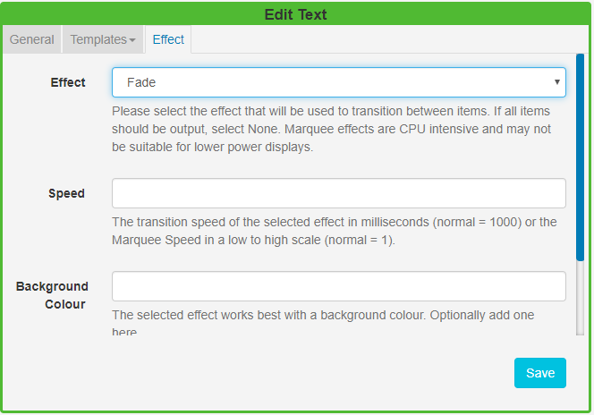

It does indeed appear that the background option is only visible when you select an effect:
Whilst we look into this use the following workaround which will retain the background colour:
Select an Effect > change Background > Save
Select Effect to ‘None’ > Save
Thank you for highlighting this.
Thanks. Workaround is working.
